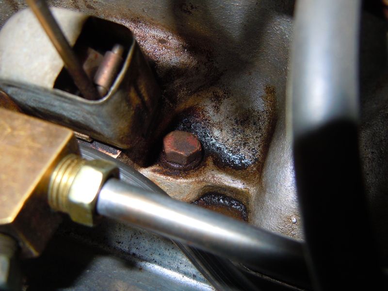

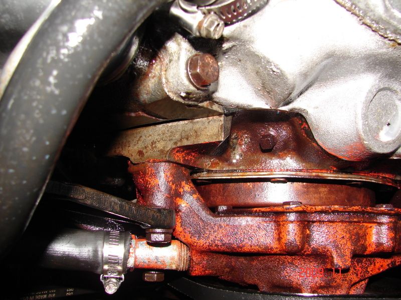

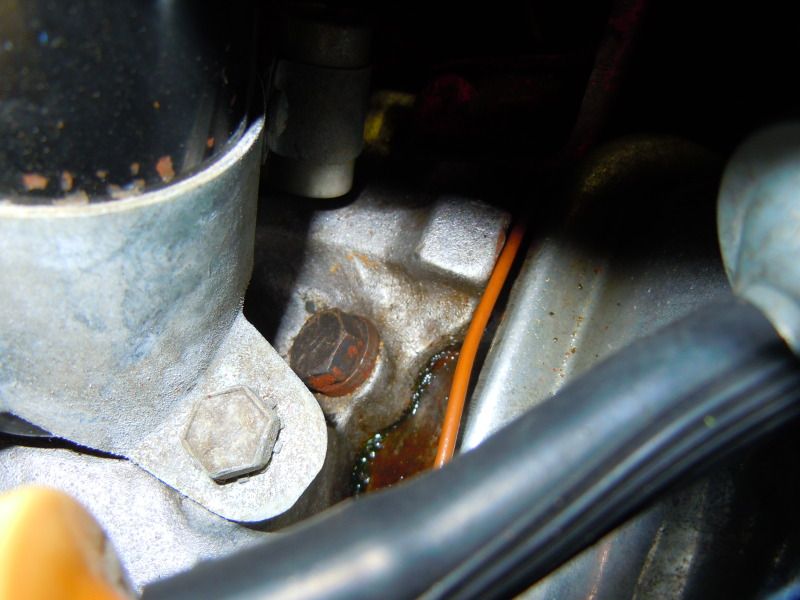

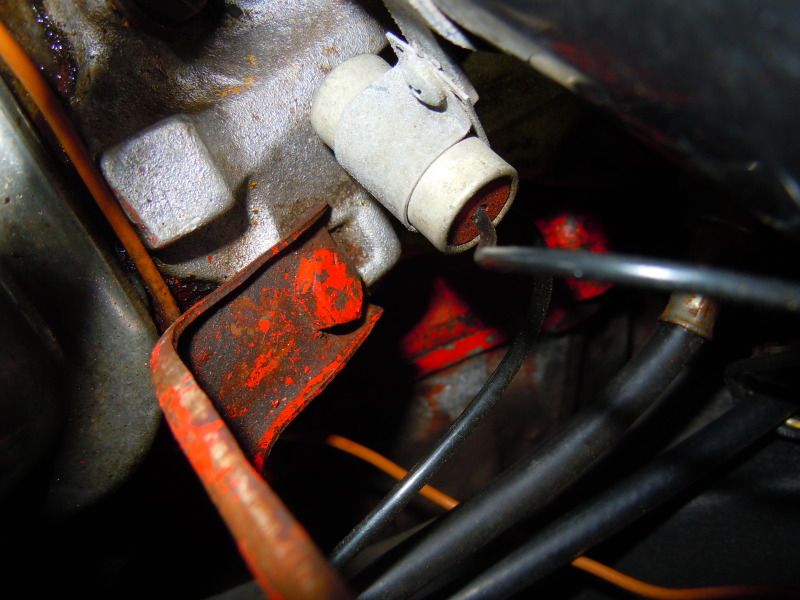

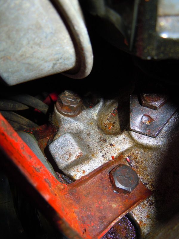

    The question I seem to get asked most often is, what bolt head marks are on my LT-1 intake, and do they have washers. Here's some pictures to help.
    Drivers Side
    First two at lift bracket flanged head, no washers "C" grade 5
    Center two TR grade 5 w/ thick washer
    Rear TR grade 5 w/ thick washer
    Last at shield bracket unable to read head mark painted orange no washer

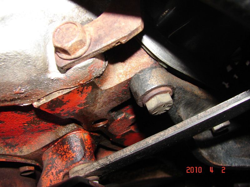

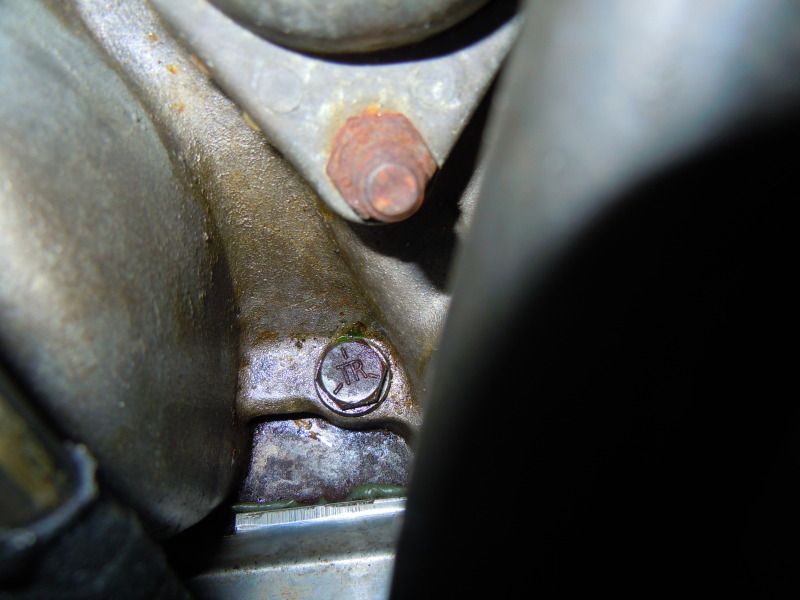

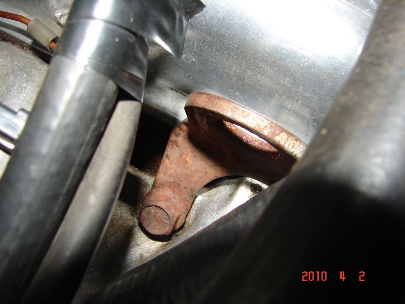

    Passenger Side
    Front "C" grade 5? w/ washer
    Second TR grade 5 w/ washer
    Center corroded unable to read w/ washer
    Center rear- stud- nut- fuel line bracket - washer-nut
    Rear at bracket unable to read head mark painted orange no washer
    Last TR grade 5 w/ washer

      Kevin, I believe 72 was the only year they used washers on LT1 , My L48 has a (C) head mark on the intake bolts. and the flanged head bolts are AP.
