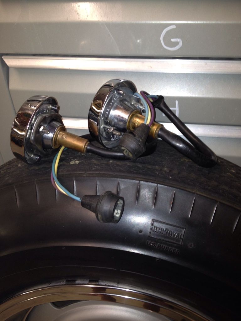

                    • Mark D.
                      1984-96 Team Leader
                      • June 30, 1988
                      • 2168
                      Re: 1967 Parking Lamps
                      This pair was taken off a 67...during an NCRS meet while the owner wasn't looking. (Disclaimer: that was a joke)
                      Kramden
                      • Bob J.
                        • December 1, 1977

                        • Mark D.
                          1984-96 Team Leader
                          • June 30, 1988
                          • 2168
                          Now, what comes after G?
                          Kramden
                          • Bob J.
                            • December 1, 1977
                            • 720
                            Looks like an H is below the G........ if you can believe the garage door
                            • Mark D.
                              1984-96 Team Leader
                              • June 30, 1988
                              • 2168
                              You're such a hayseed, those are cabinet drawers.
                              Kramden
