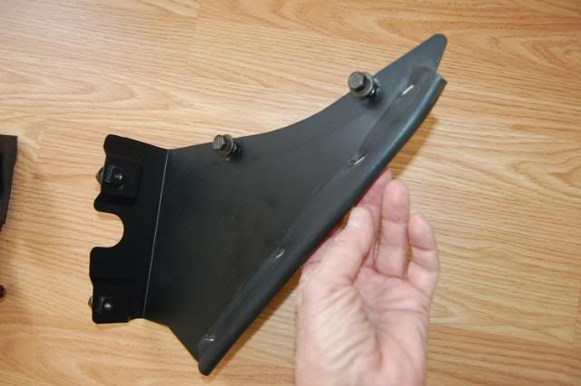

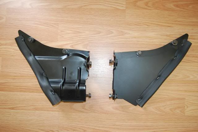

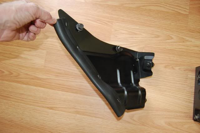

    Hi Lynn,
    Here are the splash shields from my 71.
    If these pictures don't show what you're looking for just let me know.

      Alan, thanks for the effort and pics. Seems my terminology was off. This and the this are what I was speaking of.

        Hi Lynn,
        Sorry about that.
        I have some straight on pictures of the shields, and nice close-ups of the fasteners, but none of the shields from the side.
        I'll check again this afternoon and if no one else has posted some by then I'll take some pics for you then.

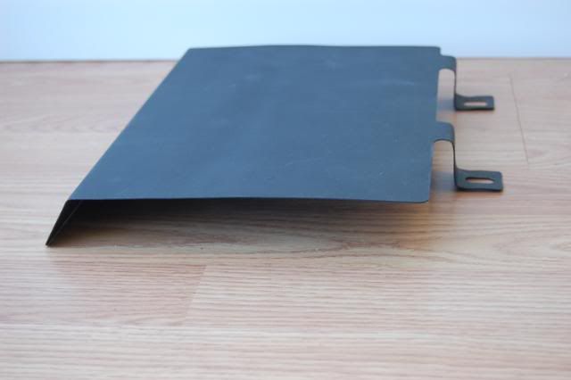

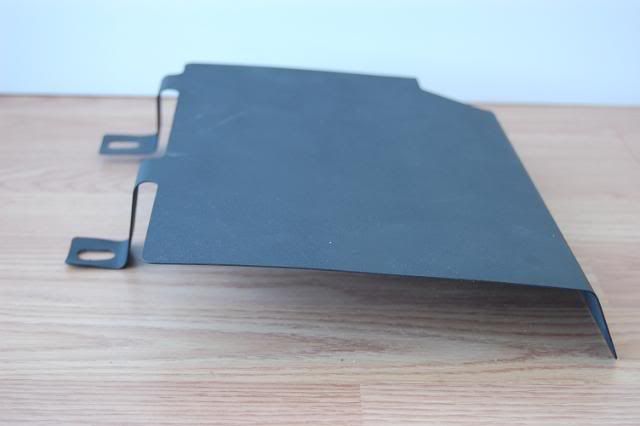

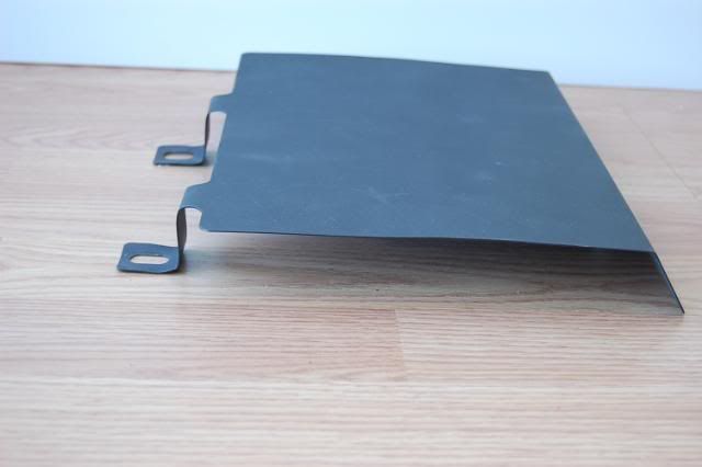

            Hi Lynn & Terry,
            Here are the shields from my 71.
            They haven't had the shape 'massaged' at all since they were removed for the first time.
            They had a new coat of manganese phosphate about a year ago.
            Hope these help Lynn!
            Left-side inner edge
            Left-side outer edge
            Right-side inner edge
            Right-side outer edge

              Alan, thanks for the pics, they helped a lot. Those are your originals I assume? Since terry asked, I guess there's a debate about it, should they be flat or curved?

                Hi Lynn,
                I'm the original owner of my car and that's the 'shape' they were when I took them off during my restoration.
                I'm not really sure how typical they may be.

                  mine were exactly like Alan's.
                  I don't remember any curvature.

                      I have seen them as in Alan's photos on my car they were also as Alan's what we could call straight. But I have also seen them with what could call a bow or curved in the area between the mounting points on many cars. The bowed ones that I have viewed do not show any signs of being bowed due to damage or bent by tooling. Have heard of some talk that wind pressure may have caused the bow but at this time I am not sure if this is just 1 of 2 normals 1 bowed and 1 straight.

                        Hi,
                        If in mounting the shield the 2 nuts are tightened on the studs so that the stud is at the 'top' of the slot first, then either the shield, or the lower mounting bracket riveted to the underbody, needs to be bent in order to fully tighten the lower screw/large washer.
                        Could the sequence of when the 3 fasteners were tightened have affected whether the shield was bowed or not?
                        Maybe?
