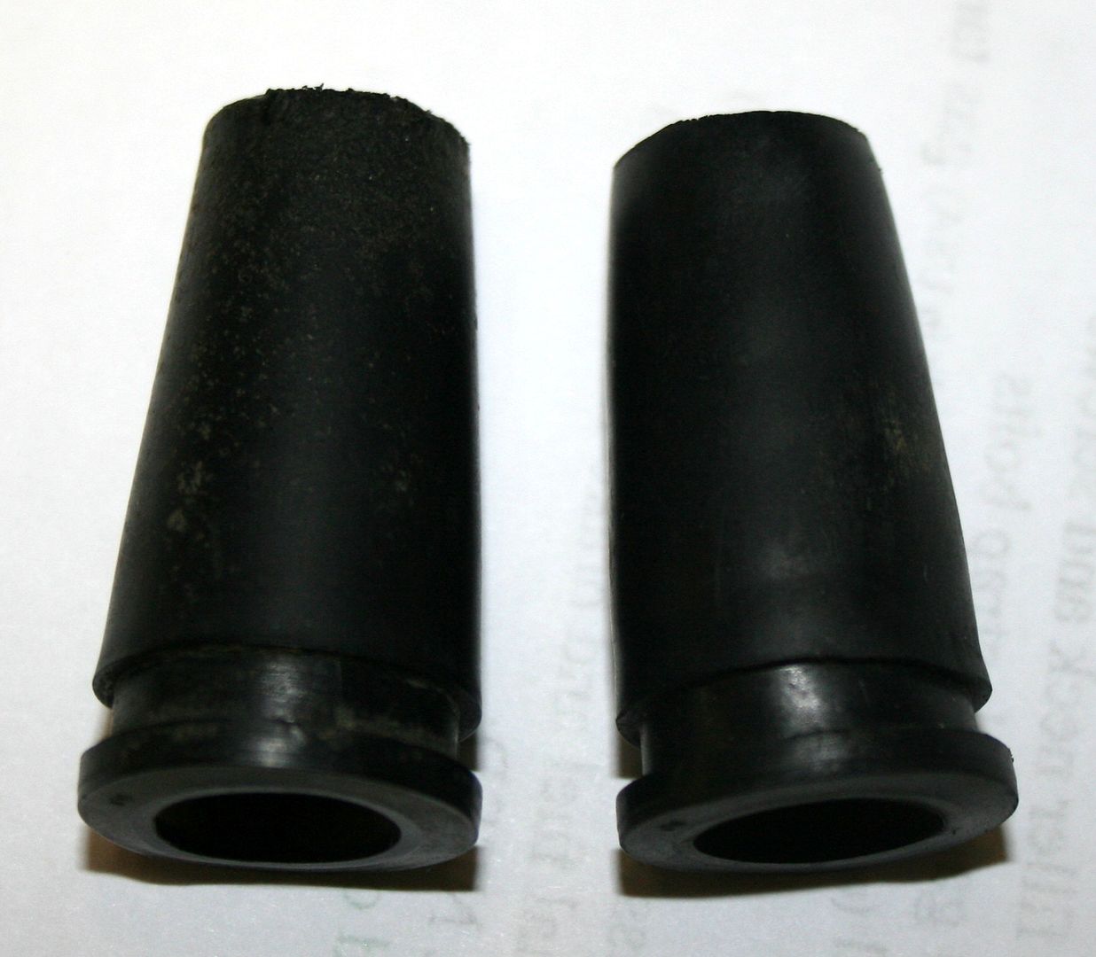

    Should there be a drain plug on the bottom or is the plug the same as the other floor pan plugs.( black, flat with no markings) I have heard there is a vented black plug with a number 2 on it. About 2" long . Thanks in advance guys . Jeff

              I purchased two that are supposed to be authentic . When I receive them I'll be glad to post pics. I have to do a little more research on my 68 march build. The plug is missing. Not sure if it should be vented or did it have the flat plug. Sorry Kurt, I'll try again. Jeff

                My bet is on the vented plug.

                  It is the vented plug that's ABOUT 2" in length. Dr. Rebuild sells a perfect reproduction.

                    Is the plug dicussed here GM#3948148 and shown in the 68 AIM as Item 13 on UPC 1 Sheet B1?

                      Yes, it is.

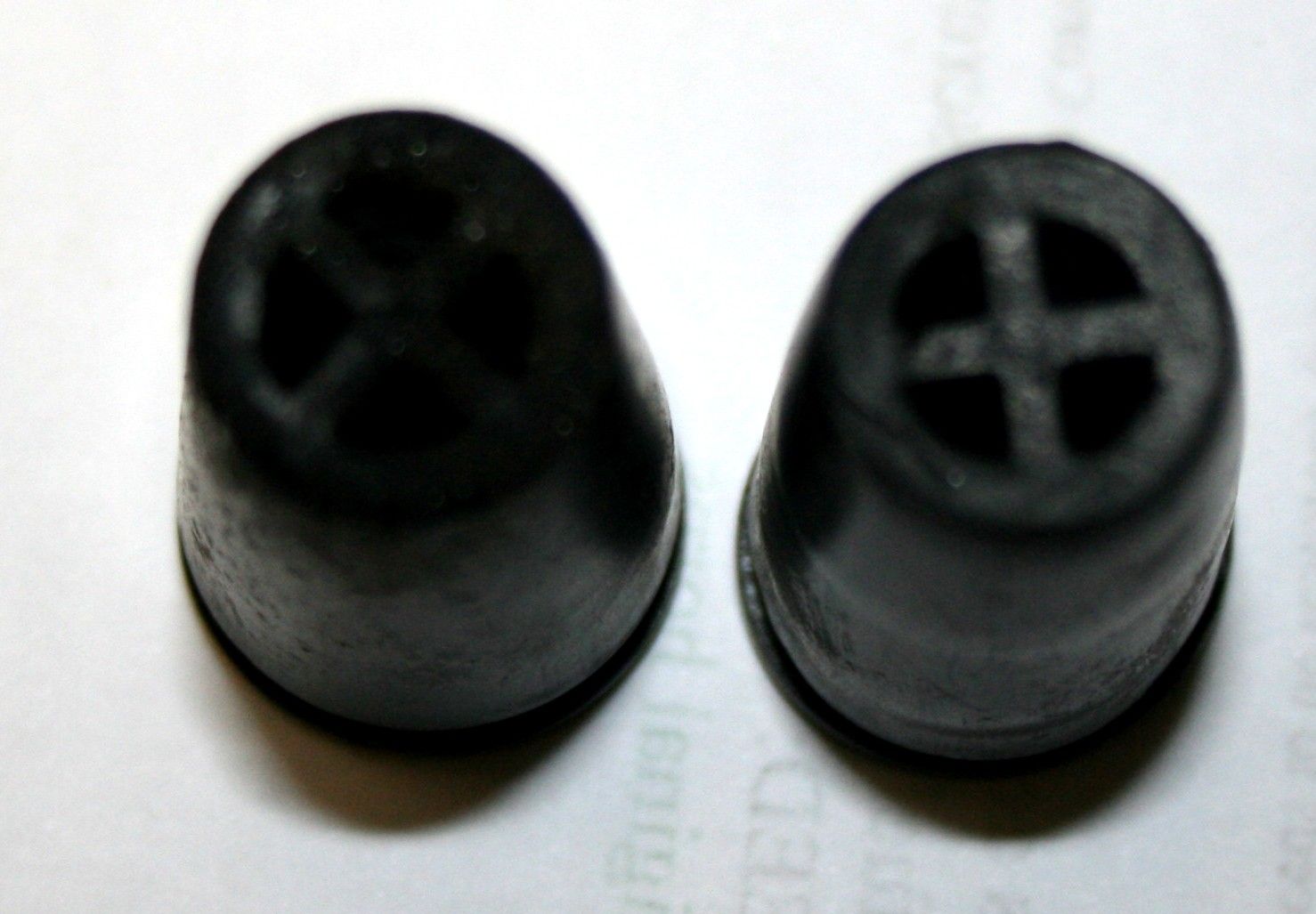

                            Thank you for the pics Mark. Are there any markings on them ? I was told there is a #2 on there somewhere. Jeff
