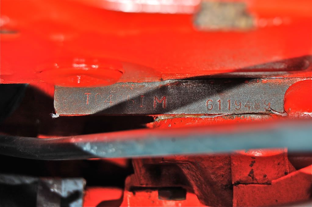

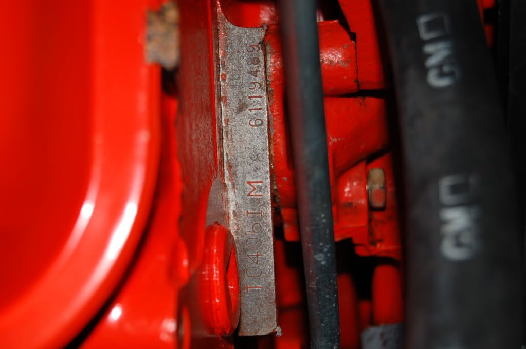

                      The Sheets are in the car currently and i am about to shut down for the evening. I will look again tomorrow. I know there was a full deduct for the pad surface. I still have to argue that any pad that is 40-50 years old is not going to look new unless it is a restamp, but....perhaps you all know someway to freshen up the condition of the metal without jepopradizing any of the originality.
                      Here are two pictures that i just took. Ill be honest, i did not realize how much paint was in the letters and numbers until i enhanced the pictures on my computer.
                      I appreciate all of the help!!! My major concern was that the previous judging was going to have lasting repercussions, but if that is not the case, then I'm not worried and it is time to move forward and make the pad look as presentable as possible for the next judging.
                      Thanks again for all of the replies!

                        Is the IM a 390 hp engine?
                        I would probably be considered a bad judge but I don't see anything wrong with this engine pad.

                          #27
                          Re: My stamp pad
                          I guess I expected much worse.

                            Re: My stamp pad
                            Tim,
                            According to this web page, it's 390 horse, four speed and A.I.R.
                            http://www.corvette.net/tech-5.htm
                            Joe

                              #29
                              Re: My stamp pad
                              I am at a TOTAL LOSS as to why a full deduction of the stamp pad was taken!? Again, we were NOT the judges on that given day, and a FULL EXPLANATION was required by the TEAM LEADER for that judging team. I really would like to know what their rationale was and how it was written up on the score sheet.
                              As far as cleaning the pad, take some WD40 or something similar and continue to wipe/clean the pad - whatever you do, DO NOT use anything abrasive to clean the pad.

                                #30
                                Re: My stamp pad
                                Thanks for the replies, they have certainly made me feel better about the stamp pad.
                                Yes, the IM code is for a 427/390hp engine with the Air Injection Reactor option.
