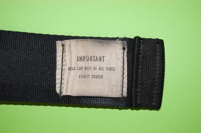

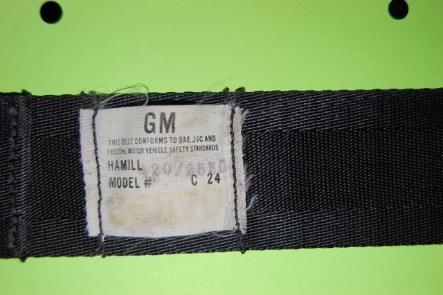

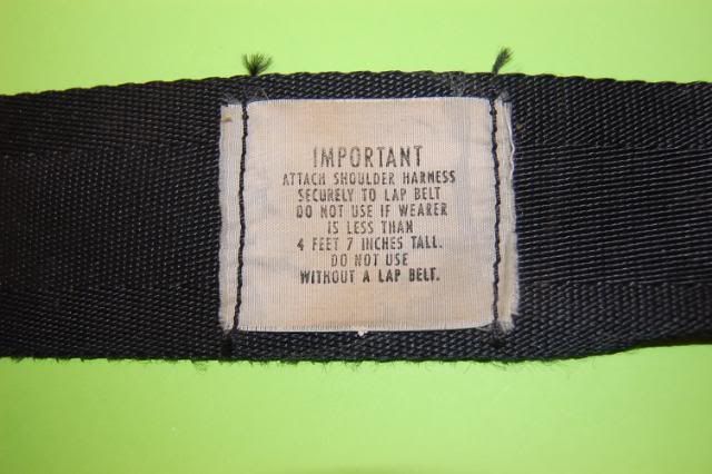

            Re: Seat belt belt and shoulder harness tag question on a 70
            Hi,
            Here are the labels from my 71. I think they show the 'silky' fabric, stitching, printing, and stamps pretty well.
            Lap Belt
            Tab/loose end
            Bolt end
            Shoulder Belt
            Tab/loose end
            Reel End
