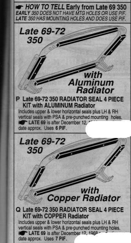

              Re: 70 350 A/C did it have front and rear baffle seals
              Your pic is definitely a support. Just appears to be the 68 version, showing the K/L seals belonging to the lower metal baffle in my pic. I should also say the metal setup appears on the 70 SB but not the A/C variety.
              Here's a pic from a vintage doc catalog,(vol.26 with the helicopter cover) showing the supports. Think you're referencing the wrong support

                Thanks Dennis.
