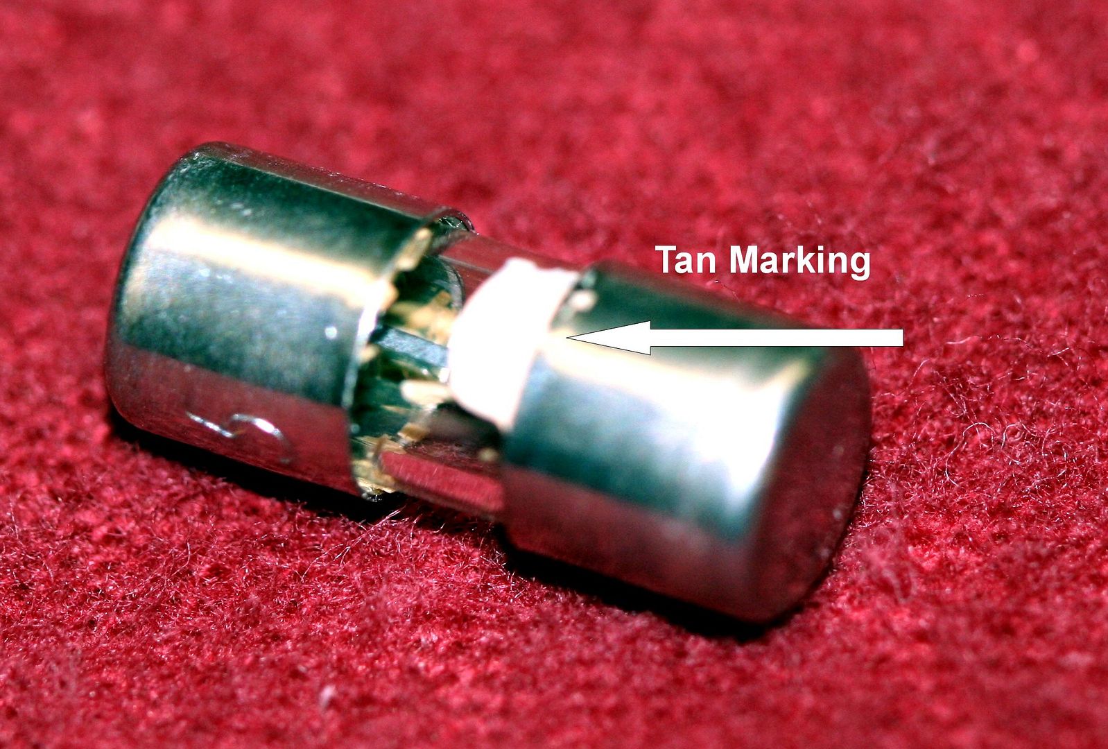

                    Here is one I bought from a mad scientist in NM.
                    Kramden

                      You are in trouble now. That looks like a missing part from Fat Man or maybe Little Boy.

                        I should have said a mad, Los Alamos, scientist bent on destroying the world.
