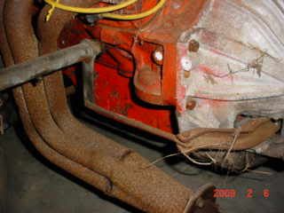

          I was just going to compliment you on the WL. It is the broadcast code for the M21 (probably with the speedo gear for the 3:70 rear). How do I know that? Just guessing, but my 1970 has WL stamped on top where it is out of sight. If yours is a 3:70, that would help cement the idea.
          BTW: Mike now that you dragged this topic into 1970. Early 1970 LT1s do not have that overspray on the bellhousing. The back of the engine was not sprayed, but painted orange by hand. How early is early? All of January production for sure, after that we will have to do some research.
          Jan 70. I know the engine had been rebuilt but I would be surprised if they caused this overspray at that time.

            Keith, what is the assembly date of your engine? My V0114CTU was brush painted by hand.

              Terry it's 0105CTU

                Interesting. Not what I would have expected.

                  I guess it's POSSIBLE that the engine was painted when it was "freshened up" (70s) and is a coinsidence that it appears like some factory oversprayed ones do. I also found overspray on the valve springs and the original fuel pump. But I assumed that to a be from a engine compartment 70s style detailing. Of coarse that would not be the case for the bell houseing. Unless all of it was done out of the car. But then why not paiint before putting things on the engine. The valve covers were not on when it was done.
                  Any other 0105CTUs with original overspray or lack of overspray?

                    Orange paint on the valve springs of LT1 engines is not uncommon. It would seem there was a number of engines that were painted without the "travel covers" in place. Fuel pumps, however, were installed at St Louis and we are told St Louis never had any orange paint. So over spray on the fuel pump has to be Bubba.
