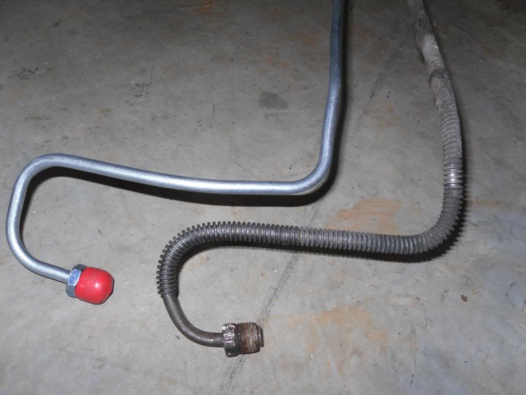

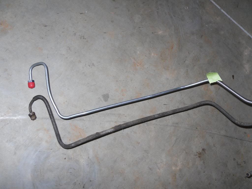

    I bought lines for my 70 and the front to rear brake line armor stops short of where my original is. My original goes to about two inches of the front. The repo is about 2 foot from the end. My buddies 69 is like the repo and does not have the front clip. Mine had the front clip which is the same clip as the others which makes it sized for the armor.
    The maker of the lines is sendiing me one like my original but seemed surprised and said they had not had any complaints about this before. So does your lines have the armor all the way to the front less 2" and do you have a clip at the very front and what year is the car?
    You can see the shiny place ini my pic where the first clip is.
    Another issue is the front to rear fuel line had about a foot of armor on it and my original had none. It was easily removed though.

      Keith, if you can purchase a section steel line with armor on it, just cut the line at the end of the fitting and slide on some more armor,and re-flare the end.or just clean up the old armor and re-use. it will slide off.

                Thanks. I got my new line today. The Right Stuff made me another with the armor all the way and onlty charged shipping.
                Terry, my three short lines at the pressure sswitch all have armor as did the originals. One had the armor a little shorter but I don't think enough to worry about.
