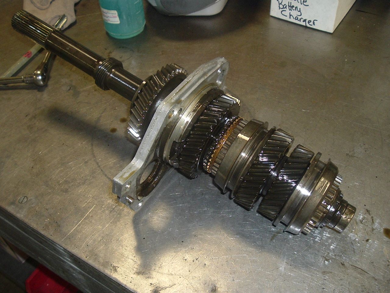

        Maybe these will help. This is a Muncie M-20 I just rebuilt but the T10 is similar.
        Here is the tail coming off & the main shaft, there not a lot of parts in the tail but could get caught up in the rev gear.

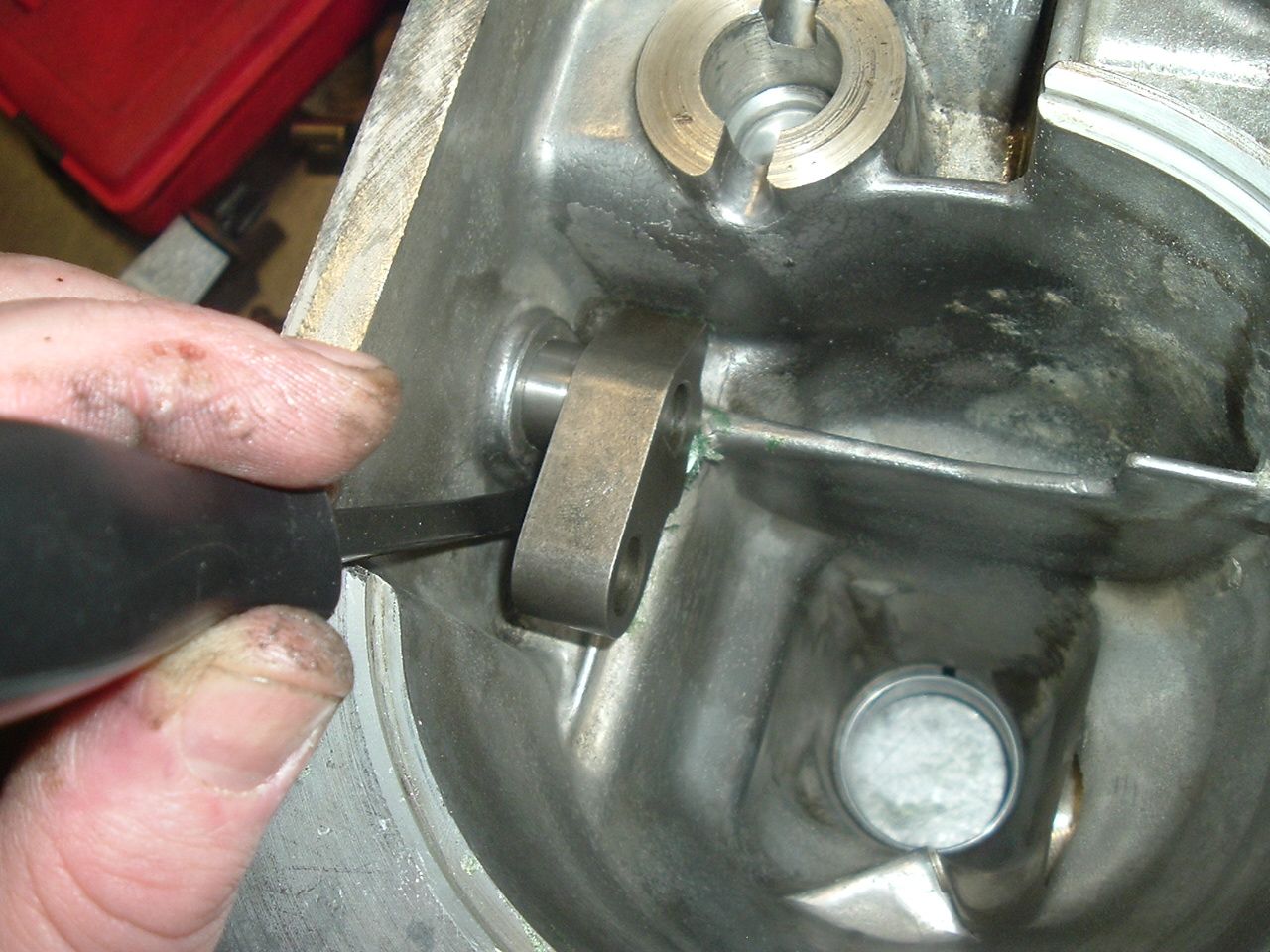

        This is looking into the tail, I'm installing the rev ball & spring but you can see what it looks like.

          Thanks for the pictures. In looking into the tail shaft I have a good idea where the plastic drive gear is sitting. I just stopped at NAPA and picked up a flexible
          retracting tool. Will give that a try before I pull out the transmission.
          Tom
