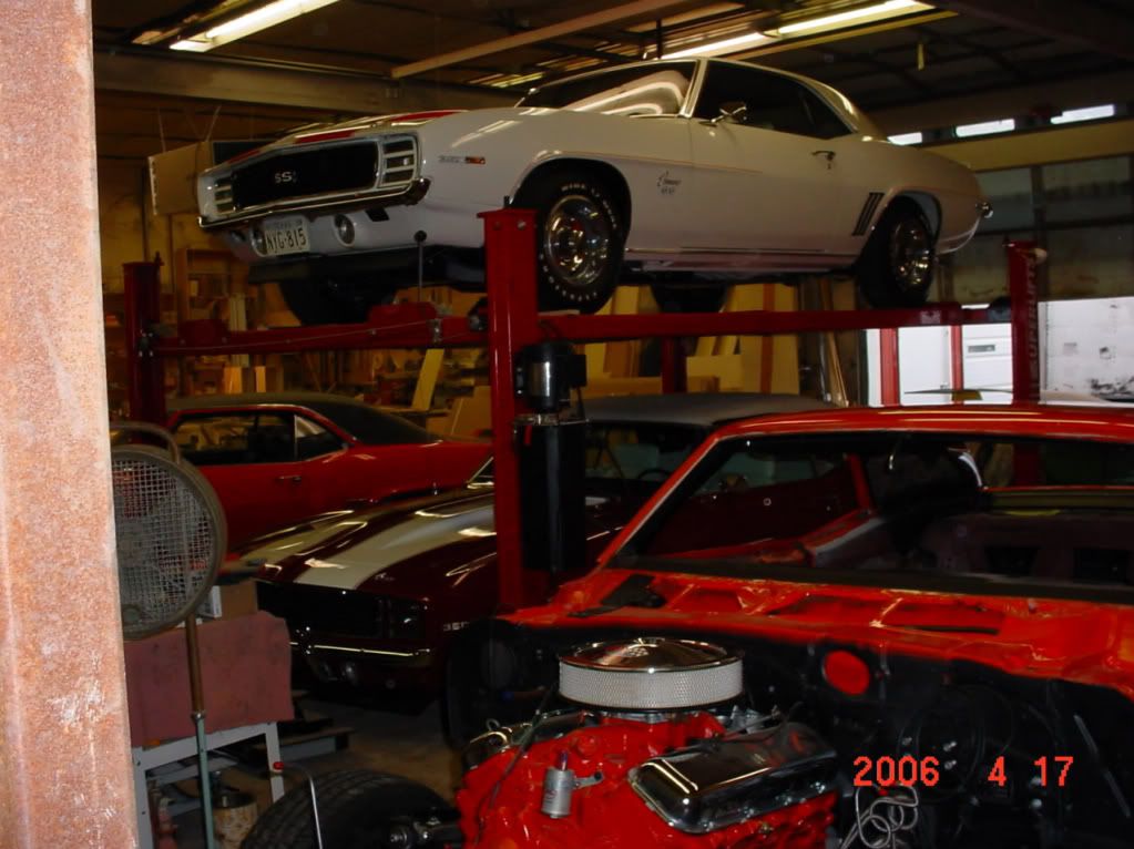

                    • Keith L.
                      • April 7, 2008
                      • 378
                      Re: C-3 68-82 Headlight Switch Vacuum Rebuild Step by Step

                            Keith,
                            is that a real Z-10? I have a customer who has a 396 Z-10.
                            Rich
