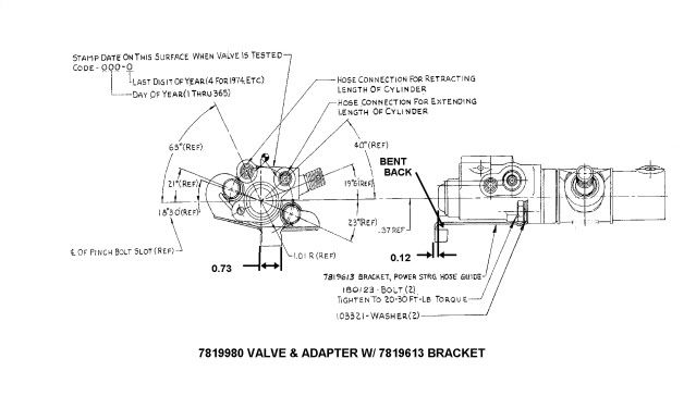

                7816806 Control Valve Assembly. The hose guide bracket was added to the drawing on 2-28-73 (Most likely for start of 1974 production.) Note, this would have been a one year only bracket.
                7816806 Control Valve Assembly. The hose guide bracket was modified, (most probably from feedback from the Corvette Assembly Plant.) This was most likely for start of 1975 production.
                As far as I can tell, Saginaw always painted the Control Valve Assembly right from first use in 1964 through 1982. The bracket would have been painted black along with the control valve.
                        Jim
                        Jim------
                        I posted photos of the GM #7817342 hose guide bracket in this thread:
                        https://www.forums.ncrs.org/showthre...17342&uid=2415
