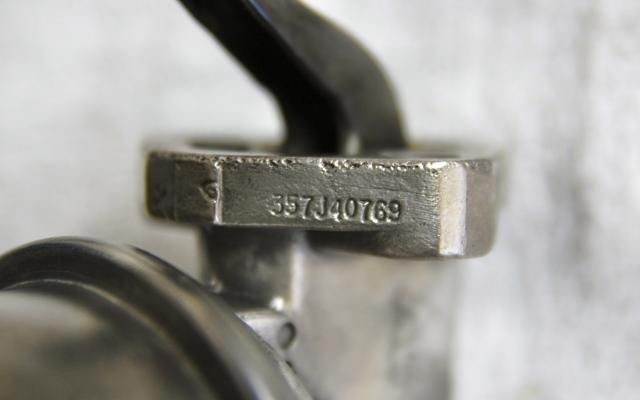

                  Hi David,
                  I didn't realize you're collecting data on fuel pumps.
                  Another member told me about your project so here's the info from the 71 sb base motor pump in my car of which I'm the original owner.
                  The block was cast on Dec.31, 1970, the engine assembled on Jan.7, 1971, and the car built about Jan. 14, 1971.
                  There are lots of parts on the car dated the last week of 1970 and the first week of 1971.

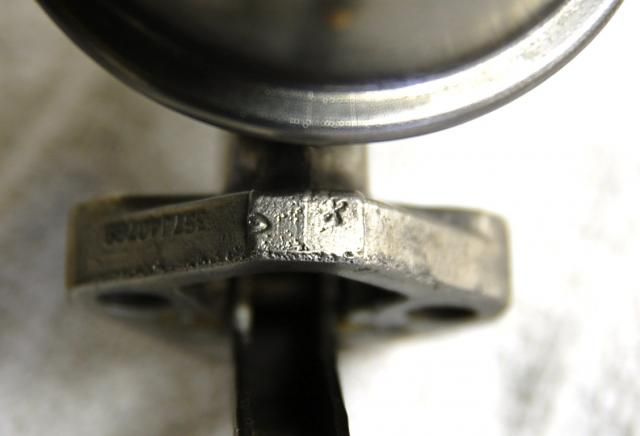

                  I've also included a picture of 2 additional stamps on the flange.
                  • David L.
                    • July 31, 1980
                    • 3310
                    Re: AC fuel pump date code research data
                    Alan,
                    I'm sure you can figure out the date code on your pump by just referring to my very first post.
                    357J = the 357th day of 1970
                    In my very first post there is a 197J40726 (197th day of 1970) original pump from a 1970 Z28.
                    Also, there is a pump stamped "DJ40726" (April 1970) also from a 1970 Z28 made in April 1970.
                    Apparently AC changed their date code system during that time from a letter representing the month to the numerical day of the month possibly for more specific quality control purposes. However, maybe they changed the date code system to confuse future restorers.
                    IMO, your pump is definitely original to your car. Thanks for you input as if further proves my theory of AC fuel pump date codes.
                    Dave
