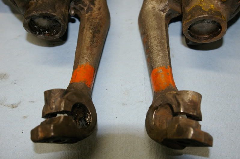

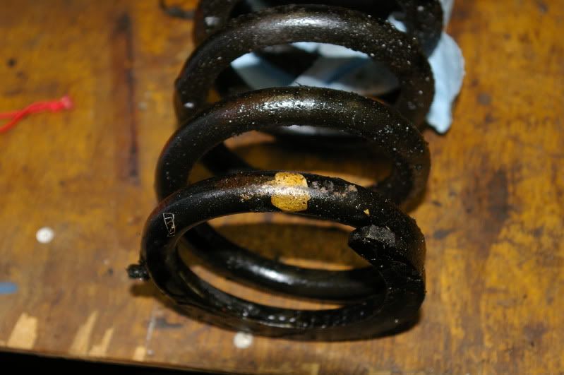

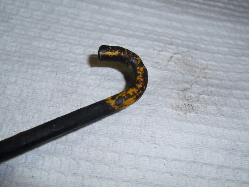

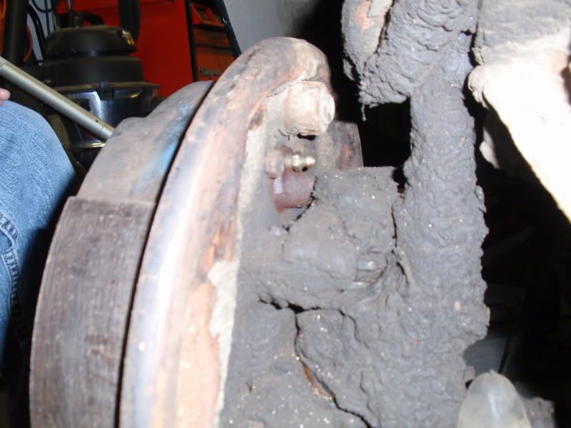

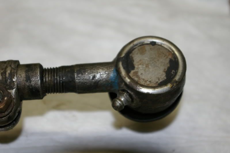

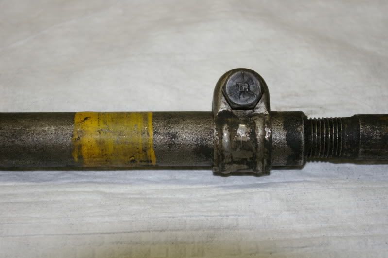

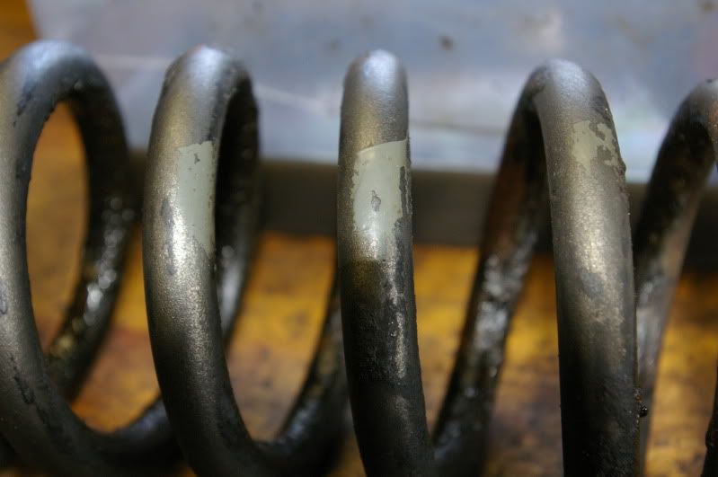

    Working on this 60 is like an archaeological dig, unearthing tons of grease to find many inspection marks still intact.
    Fun stuff..............
    Front spring
    Tie Rod
    Inner Tie Rod
    Outer Tie Rod
    Top of spring
    Spindles
    Clutch return spring
    Protective covering.......

            I used Mineral Spirits and a couple of different nylon bristle brushes. The mineral spirits did attack the tar based black paint, but left the inspection marks intact. I also used plenty of paper towel rags to wipe the parts down. Just remember to dispose of the solvent soaked rags in a safe manner. I put mine outside of the garage in the metal trash can.
            Interesting though, the yellow used on the tie rods must be a different paint from the yellow on the spindle and clutch spring. I say this because the yellow on both the spindle and clutch sping seems to be lifted into the grease and was difficult to keep intact. The yellow on the tie rods was not affected by the grease and stayed on the metal.

              I used a gasket scraper along with some other tools to remove the bulk of the grease. Then mineral spirits and a nylon brush to get the last of it off.

                  On my early 57 I used lacquer thinner to clean the suspension parts and differential. It cleaned off all the grease and oil but left the inspection marks in great condition.
                  To preserve the marks I just sprayed the parts with a matt finish clear.
