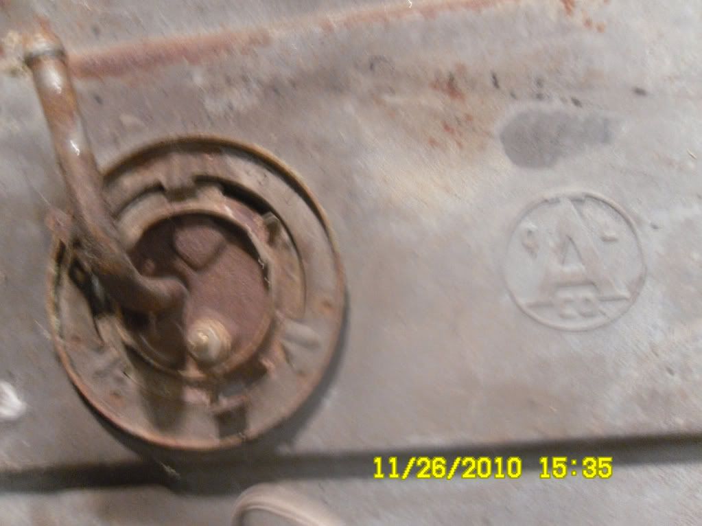

                    Jerome, The OL Anderson logo is the only other way I know, And of the age of tank is sometimes visible from the look of the plating.
                    The logo is visible sometimes if you drop the spare tire down it generally in the area of the fuel sender.
                    • Keith L.
                      • April 7, 2008
                      • 378
                      Re: 1972 gas tank
                      sThis is a 70
