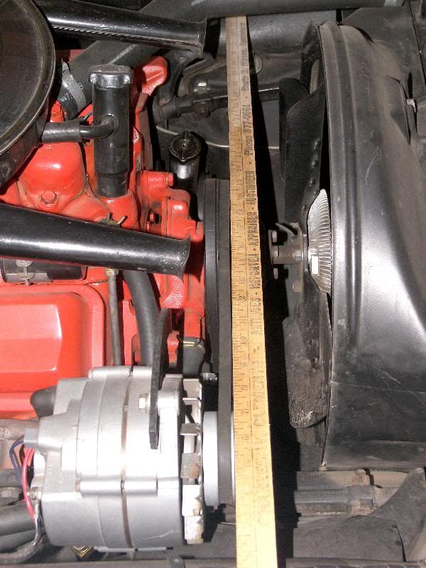

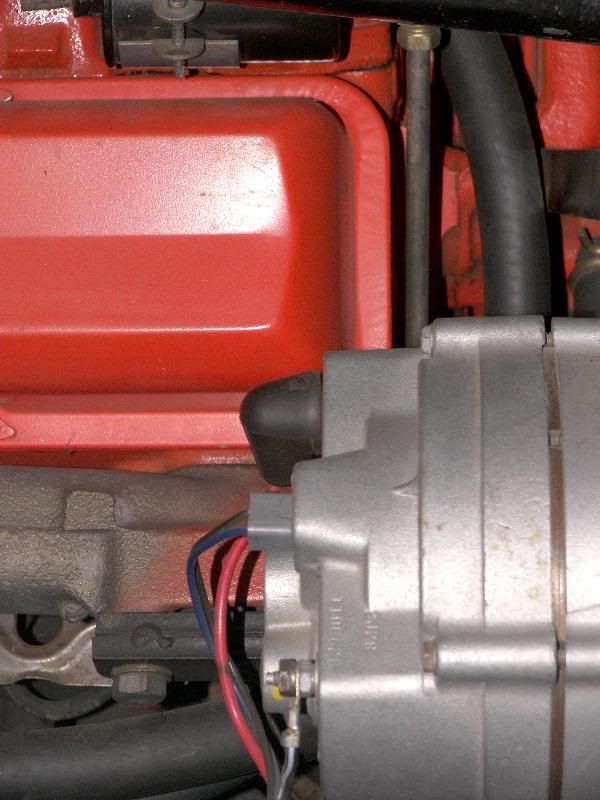

        Re: Alternator Alignment 1963 327/250HP
        Here are a couple of pictures of the alternator belt and alternator of my '63, with a 327/300 engine. AFAIK, the 250 and 300 engines used the same belt and pulley configuration.
        I like to use a straight edge to verify pulley alignment; my eyes can play tricks on me otherwise. I lay the straight edge against the machined surface of the alternator pulley and see how the path of the belt tracks the path of the straight edge:
        Since there is some question about the position of your alternator, I also made a picture that shows the alternator relative to the valve cover:
        Hope these help.
        Jim
        Edit: A sharp eye will notice the rear sheave of the water pump pulley has a belt in it. That's a redundant belt that circles only the water pump pulley and crank pulley. I drive this car everywhere (note the dirt/dust) and don't want a belt failure to leave me stranded.

          #19
          Nice pics Jim, Here are some from my car showing the relationship between the lower bracket and exhaust manifold.
          I don't know if you can determine if the lower bracket is correct from these pics but if you need me to later I can take a pic of a spare bracket next to the passenger car bracket.
          Also, look at the routing of the 5/8" heater hose that runs forward of the top alternator adjustment bracket. I believe this is correct and the arrangment keeps the hose from rubbing the bracket.
