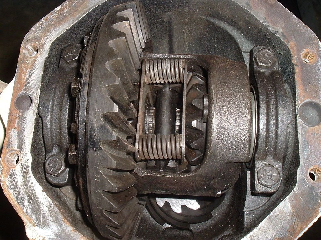

                      Here is a stock diff with posi. Notice the springs and plates and the cross shaft the yoke ends ride against.

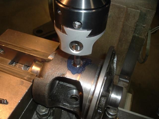

                      Here is a posi case that had a sloppy side hole for the cross shaft. This allowed the yokes to walk in/out .125",the posi set up was the stock version which was not setup correct but the 40 year old yokes were fine, in fact I had to face grind them to dial in 005 endplay. This case I bored and fit with a 12 bolt shaft and spiders,making it stronger then any stock case setup.
                      Hope this helps with the understanding of the unit.
