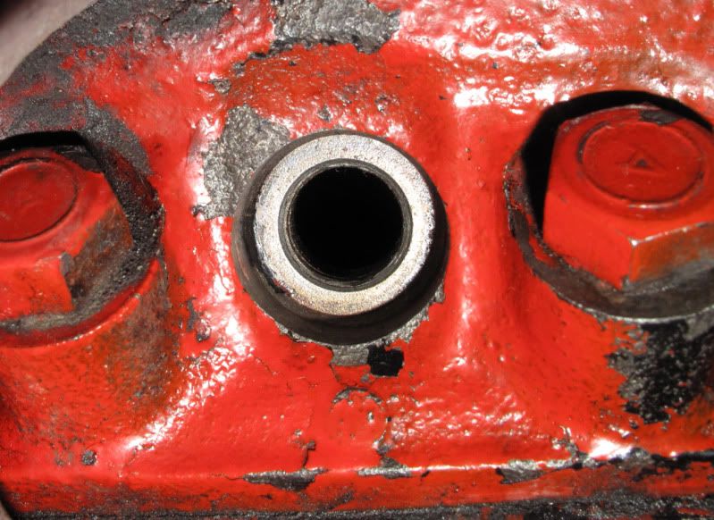

    cleaning the plug ports was a pita. i did two today and took me a good half an hour. tomorrow i'll do the rest.
    do you use a copper based anti-seize on the plug threads?
    here's a photo of the cleaned port!

      I've never used anti-seize on iron heads. And I no longer use it on Al. heads. It makes to big a mess.
      Install the plugs with a torque wrench to the specified torque and pull them for inspection every 10K miles or 5 years and they won't seize.
