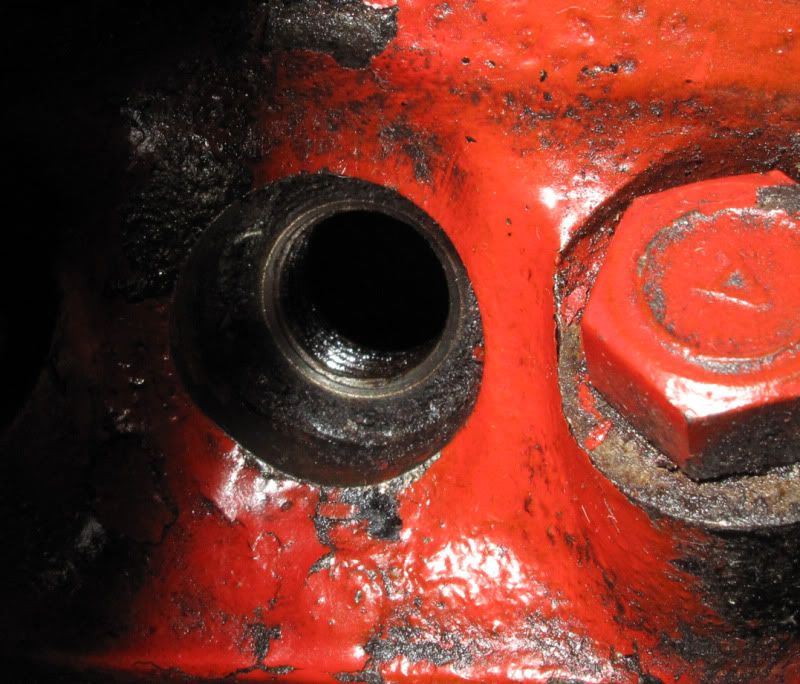

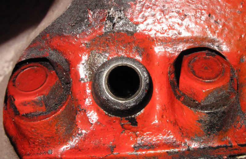

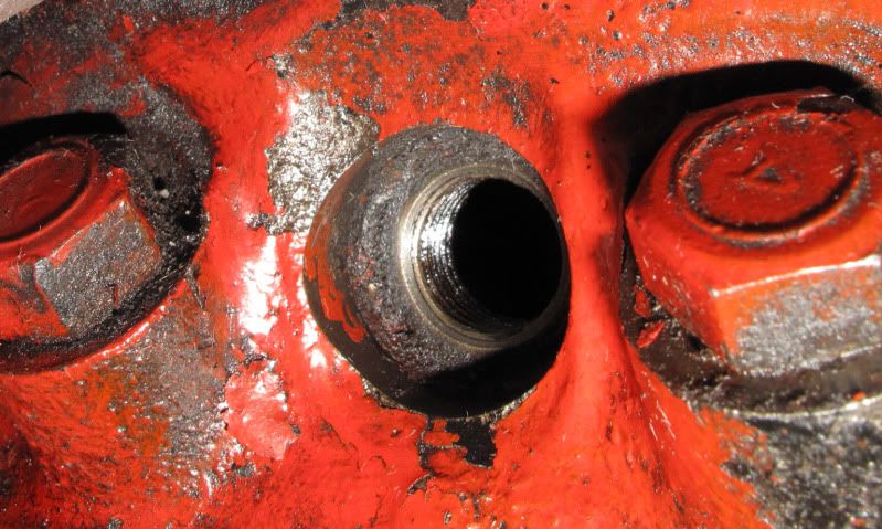

                  i also pulled one of the spark plugs (champion rv17yc tapered) to see what kind of plug port my head has. can't really see what i should be looking for in a tapered plug port or a gasket plug port. i did notice that a
                  small area of the tapered port of the port was shiny bare metal
                  btw, i was able to screw in a gasket plug (without its gasket) that i have and it seated.

                    It appears that head was originally machined for tapered seat plugs, but the large diameter spark plug port could also be machined for gasket seat plugs.
                    So the correct plug would be AC R45T or equivalent in another brand, and the Champion RV17YC is okay. It's roughly equivalent in heat range to AC 5 to 6, but has an extended tip so it's equivalent to the R45TS or R46TS.
                    This is an anamolous situation because '70 LT-1s with 186 heads "should" be machined for gasket seat plugs.

                        These heads are designed and machined for GASKETED spark plugs. Someone apparently previously installed tapered seat plugs but these are not correct for these heads. They will "work" due to the normal thread lead-in chamfer, but they're not correct, functionally or otherwise.

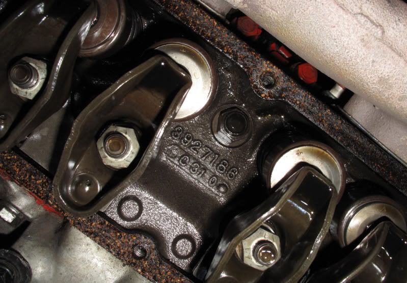

                        The left 2 photos below show a KNOWN tapered seat machining in a GM #3991492 cylinder head. The spark plug counterbore is about 0.675".
                        The photo on the right shows a KNOWN gasketed seat spark plug machining on a GM #3927186 cylinder head. Note that there is a thread lead-in chamfer just like yours but this does not represent a seat for a tapered seat spark plug. The spark plug counterbore on this head is about 0.885" which should be about the same as yours.
                        So, when you reinstall spark plugs, use the gasketed type plugs. Also, make sure you fully clean the seats at the base of the counterbore of dirt and grease. As a result of the installation of the tapered seat plugs this area has been exposed to such and obviously needs thorough cleaning.

                          When I first looked at Wolf's pictures, the head casting was clearly designed for gasket seat plugs, but the gasket seat appeared to have not been machined!!!
                          On further inspection, what I think I am seeing is debris buildup on the machined gasket seat surface due to the use of the small diameter taper seat plug.
                          I believe once this area is cleaned of debris it will be clear that there is a machined gasket seat.
                          Recommend you loosely install the "peanut plugs" and use solvent and a toothbrush, toothpicks,... whatever will work to clean out the debris and keep it from falling onto the threads and getting into the cylinders.
                          It all seems perfectly clear, now - Bubba was there. I should have known!
