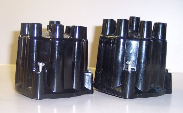

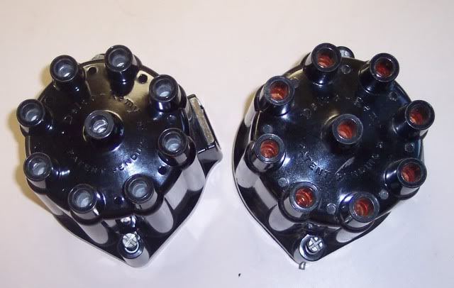

    This evening I pulled out an NOS Delco distributor cap (purchased years ago) to use on my latest project. Immediately noticed some differences as compared to another Delco Remy cap I have. Both say "Delco Remy, patient pending, R". The NOS cap has different contact material and pin height is shorter than the other cap. Could the NOS cap be a fuelie cap? What goes here?

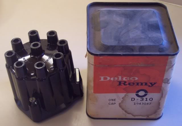

        It could be a D-310, aka GM #1943047. This cap was used for 1963-65 Corvettes with FI as well as 1959-64 Oldsmobiles. I was not aware that some of these caps had the "R" on them, though. Do you have the Delco box the cap was supplied in?

          I'd settle for the one on the right with copper terminals.

            Checked my Delco blueprints (copies)-was curious about the copper terminal cap in black vs. brown.
            In all 67 and very early 68 dates of drawings I find OEM P/N #800061, primarily used on the L-88, was "Brown" in color and had copper terminals. Then in the 69 dated drawings, the same P/N, still used the copper terminals, but now was "Black". Don't know the NOS P/N you have, but it appears was based on the #800061 for Hi Performance applications.
            Both the FI cap and the copper cap would have been manufactured after 69, based on the "R". Interesting footnote: the Delco drawings do not show the "Patent Pending" on either non-"R" or "R" versions-thought that was interesting.

              1943047 is the number on the box.....purchased back in the 90's, in the box since. Have been waiting for a project to use on. Apparently that's all changed now as I'm restoring a '66 BB roadster. Why on this particular Delco cap is pin height shorter than the standard Delco cap?

                      The FI distributor used a spacer between the distributor and the manifold. This caused the distributor to rise higher. As a result, interference with the 63-65 top distributor shield and the plug wire distributor end boots would occur. The shorter overall height of the D-310 cap compensated for this and prevented interference.

                        Joe - I've had several of these D-310s w/ the embossed R NOS in Delco-Remy pull string boxes and all were p/n 1943047 and there were no indications, such as D-310R, on the boxes that the caps had the embossed R. The NOS D309R I have that is embossed w/ PATENT PENDING R has p/n 800061 on the box. Pete

                          Joe, others -- here's an eBay D-310 short tower FI cap with what looks like its original red/white/blue pull-string box (not the earlier orange black white). It has the "R".
