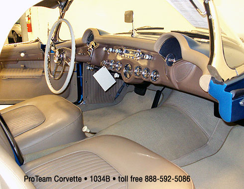

        Here's Cascade Green/Shoreline Beige in my 1957:

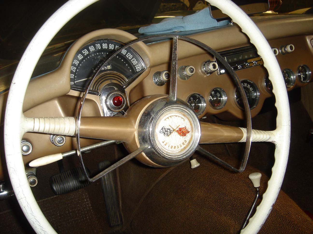

        I've never seen a Pennant Blue/Shoreline Beige 1954. Even though Noland Adam's book calls out Pennant Blue/Shoreline Beige I think he is incorrect.
        Here's an interior shot of car #3300 with original paint. Although a little worse for wear, it's definitely not a Shoreline Beige interior:
