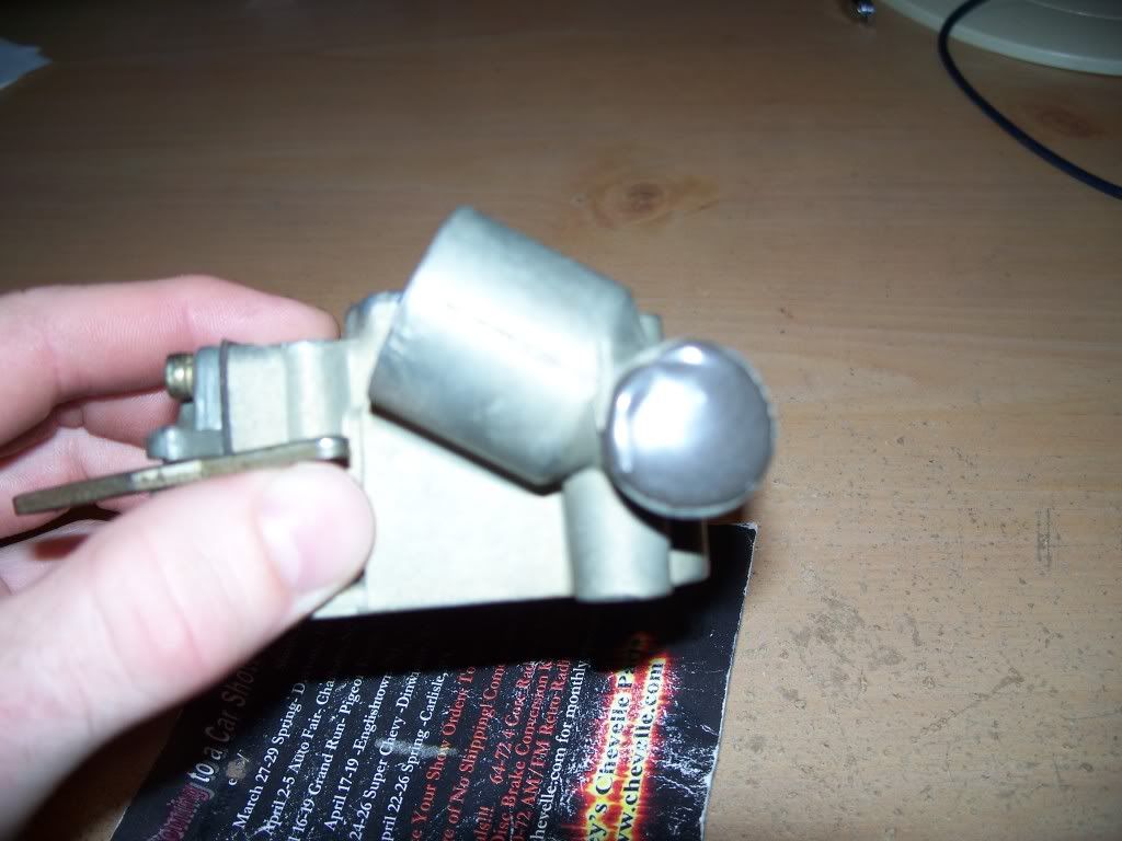

              Re: Holley carb front bowl leaking. epoxy?
              the dark round spot is the one in question. that is were the fuel was running out. this is the bad front bowl.
                Keith,
                Many restorers use a dab of epoxy at the locations shown on your picture. You had me thinking the epoxy is where the transfer tube and O ring goes into the side of the float bowl.
                Many times if the float bowl is removed and the transfer tube O ring is exposed to air outside of the small bore it will leak.
                  A guy many NCRS people recommended for carb rebuilds ads this daub of epoxy as a safety measure to prevent fuel leak - fires because that design was flawed from Holley. And is probably why these carbs are so hard to find today.
                  Yes, does not pass NCRS, can't be that much of a deduction right?
