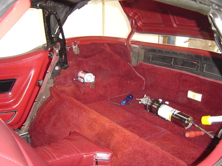

                          The 1974 convertible did not have the RPO A85 cut-outs. When I installed shoulder belts I did that job myself. The aftermarket pre-cut versions are $300.00/pair!
                          Two cuts are offered and in fact if you look carefully you can see the outlines in the trim piece pic above. The early-1974 cut was 2 7/16 x 3 1/4" and late 1974 was 3 1/4 x 3 13/16". I chose the former but should have chosen the latter based on a May 1974 build date. But the larger opening intrudes into the sidewall of the piece and that did not seem to be a wise move. All works well so no regrets.

                              The panels did change for the 1974 model year. In fact, there were TWO sets of panels used for 1974 but they are dependent on when the car was built. VERY early 1974 may have used GM #333337 and 333338 panels. Later used GM #339127 and 339128. All 1975 used the latter panels.
                              The 333337 and 333338 panels became the SERVICE panels for 70-73 models.
                              The 1968-69 panels were an interesting design. They used a plastic substrate material with a vinyl material stretched over the plastic to form the visible surface layer. I don't know if the original 70-73 panels were of this design. I would be interested to find out if any 70-73 owners with original panels could enlighten us.
                              I think that the 333337 and 333338 panels were of "monolithic" plastic material.
                              From what I can see in your photos, the 74-75 were also of the "monolithic" plastic material.
                              Are there any part numbers embossed on the rear of your panels?
