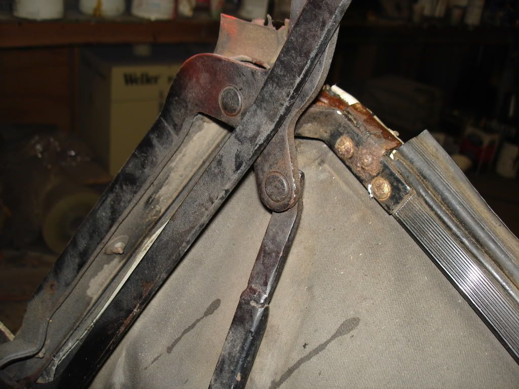

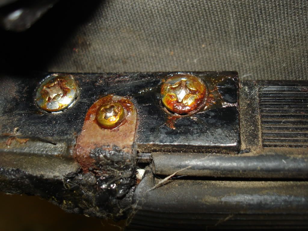

              OK, Here is something to look at.

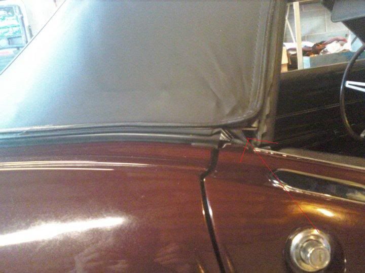

                  Re: convertible rear bow weather stripping, do you remove the piping cord from the or
                  Ok there wayne more questions~ haha.
                  in the picture you can see where I cut the W/S at, a bit too long still I know but I wanted to cut too little off than too much.
                  anyway, see the open space I put a arrow pointing to? what goes there I didn't see anything in a kit or seperate that would take care of that, I'm lost? and I knwo you mentioned a "filler" so what did you mean by that? are you talking about that area?

                    You are looking right at it in the top picture.
