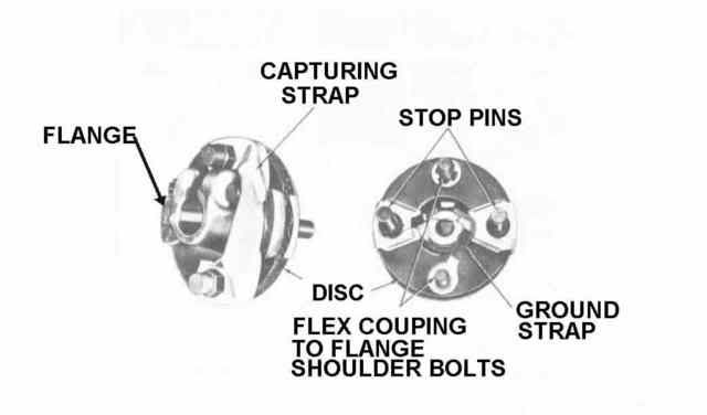

              The 1967-68-and until late 1969 the basic flexible coupling was the same. It had a gear flange with a full round serration. (Late 1969 a flat was machined on the gear input shaft and the flange on the flexible coupling had a matching flat added.)
              The basic hardware on the 1967-68 flexible coupling was the same as a lot of other GM flex couplings. The shoulder bolts were slightly different. These shoulder bolts had extensions on the hex head side of the bolt. These bolts were fairly common on flexible couplings used on rear steer vehicles during that time. You can see the extended head bolts in this generic flex coupling picture.
              This picture would be accurate for the 67-68 flex coupling except for the capturing strap. There was no capturing strap on 1967-68 OEM flex couplings, it hadn't been invented yet.
