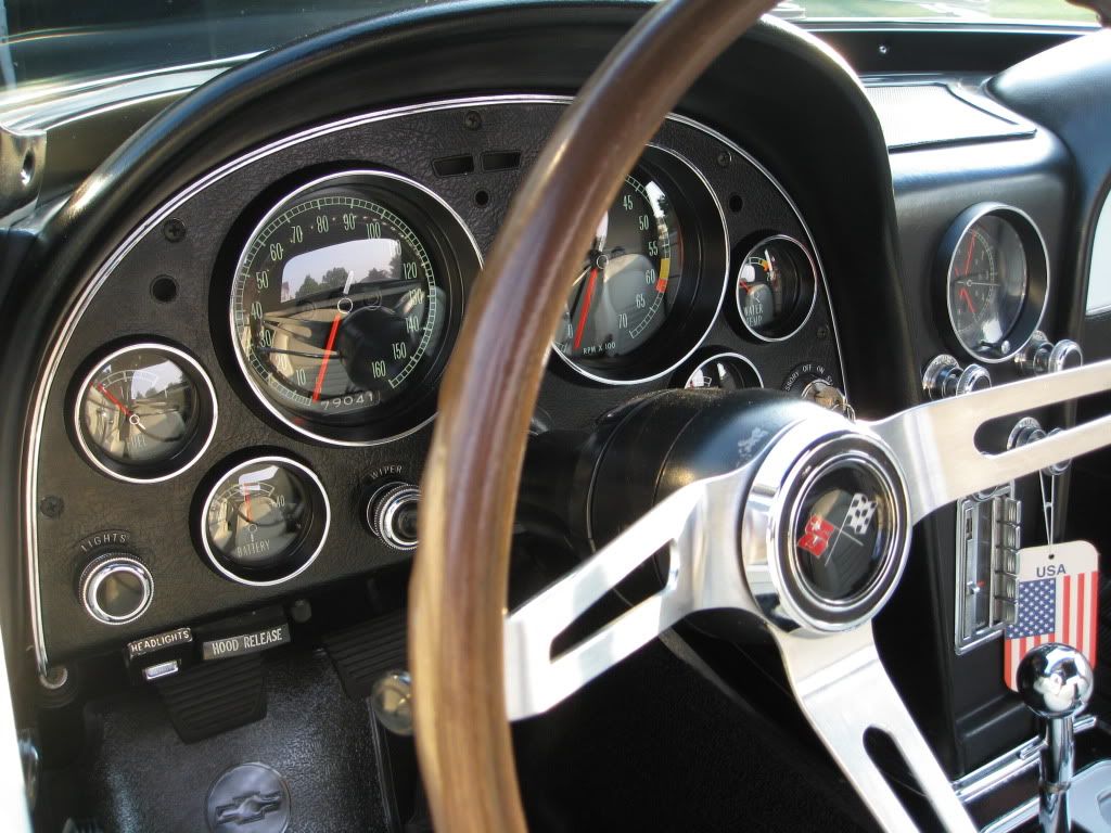

                        Here's my original, 327/350 no speed warning.
