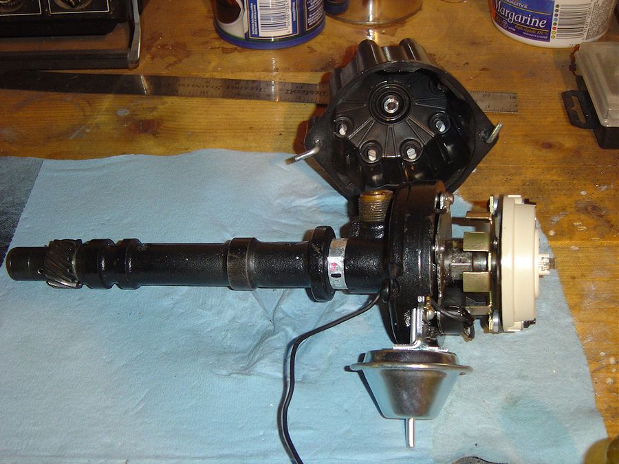

                      Re: I'll Try Lectric Limited Breakerless SE This Summerr
                      The unit arrived today and the installation is done. For some reason my EBay distributor had the ground wire soldered/installed in a location that interfered with the module. I relocated that as per the Lectric pics. And they are not very good. Nor are the instructions. In fact to see blurry pics beyond the instructions you have to go back to the web site. Rather strange for a professional group. The M&H pics are a little better but not by much.
                      I also ordered a D512R coil that is purportedly compatible with the Breakerless SE for my 1974. But when I read the instuctions I see a D511R coil is?? Yet there is no D511R on the web site??
                      In any case, the job is done. Yes those white NAPA-type rotors do need the square tip cut back to ~1/8" for the rotor to mount properly. But that is but a one-minute job with a file. The round tip is fine. So...will it work? We shall see in April. But my confidence is a little shaken by their poor literature and the coil matter. Points and condensor on reserve in the back compartment!
                      BTW, don't try this conversion with the distributor in the car. It was tricky enough on the bench getting those liitle screws in place.

                          I am surprised you had any problem with the installation, can you post a pic of the soldered wire you describe as problematic. The instructions with mine were clear as a bell. Going from memory, there may be a sentence about lifting/bending the soldered ground wire up out of the way so the module sits flat on the contact plate and I don't think I even had to do that. Also, a little clip to hold the ground wire from interfering with the shutter wheel.
