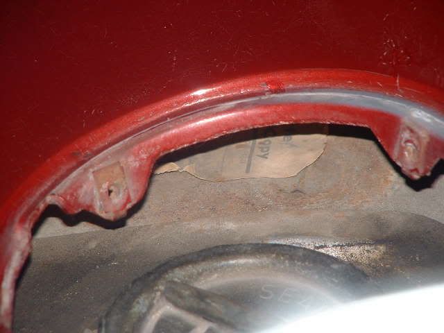

            Re: Tank Sticker
            Here's what I could see.

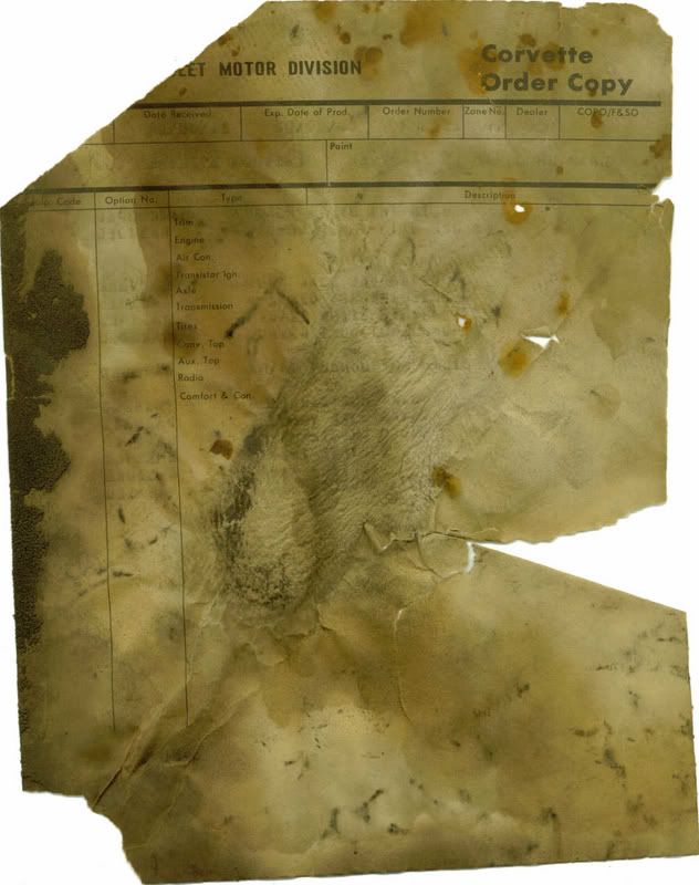

            And what it looked like when I got it off.
            Fortunately, I had an order copy that was very clear. I could only make out enough on the tank sticker to confirn the LT-1 and tell it was the same a the order copy.
