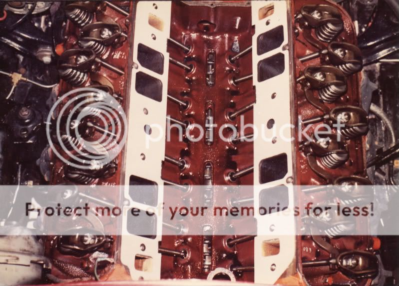

      This is a SB400 that I painted over 10yrs ago.
      This is another SB400 in the Chevelle that I painted and built in 98. I had to pull a head because of a pinhole in #2 combustion chamber that went into the water jacket. By the way, notice how clean #2 piston is from water in the combustion chamber!
      This is under the valve cover of the 400 in the 56.
      This is a freshly painted 420SB that I built for the boat. Notice the old cam/lifters in place for painting.
      Oh ya, and here is how to make good use of the plugged hole in the front of the block----------put an oil pressure gauge in it!
        Looks like a lot of work. Nice job though.
        Slightly off topic... are those main cap studs using SAE fine thread nuts?

            No, those are the factory Chevy bolts/studs for windage trays. The stud end has 3/8-16 threads. I always use a lockwasher under the nut.
