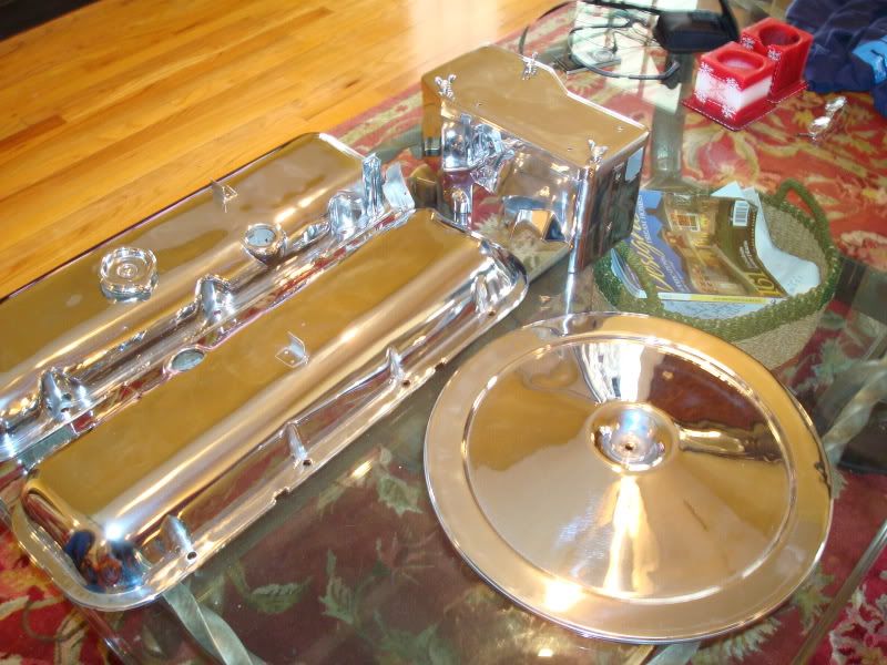

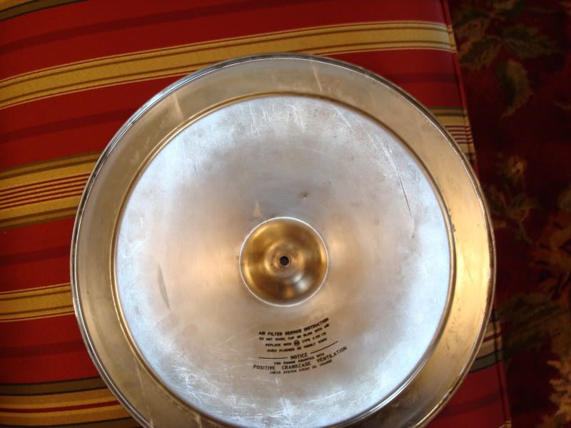

            I thought about how to go about it for a long time before I chose to have all my original pieces re-chromed and I'm glad I went that route. I had them to tape out the under side of my air cleaner lid to keep the original silk screening because you can tell paragons repro silk screening EASY from the original, it's nothing near the same.
            here are mine after being redone u can see the original silk screening they taped out and it was hard to find a shop that wold tape it out, why I have no clue? Most didn't want to tape it thought they said NOPE that will be gone.
            if yours has the shielding like this do know that there are plastic rivets that rivet to the top to hold a plastic sheet of sheilding on, you need to remove yourself or they will be gone when you get it back...trust me I NOW know...wish I had caught that before hand.
