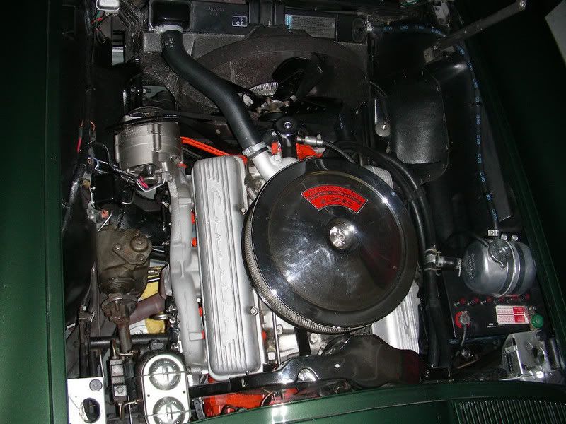

                      Here is a shot of my 67 battery.
                      merry Christmas,
                      Rick
