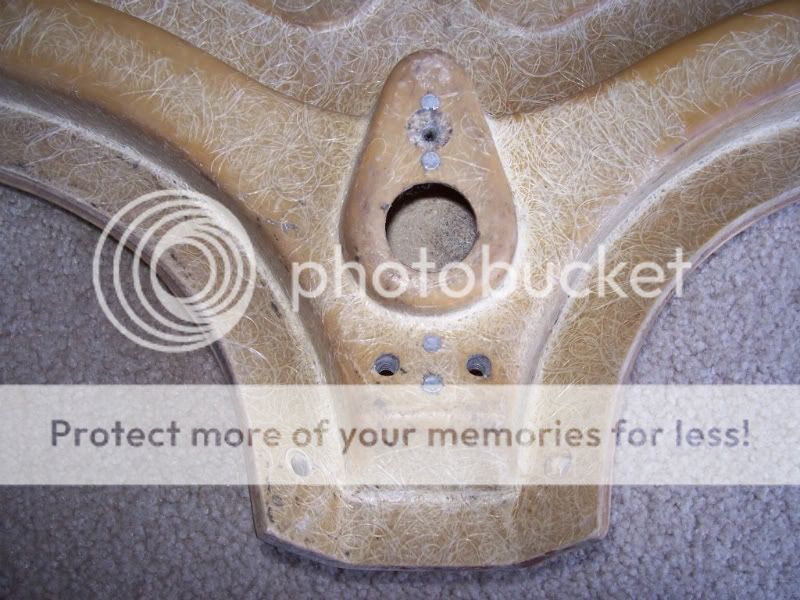

    I have, what I thought, are two original soft top deck lids. I was taking the paint off of them and I noticed that the attachment areas, where the male half of the locking mechanism is (the area that goes down between the seat and above the center glove box) are different. One has a large hole in it, with a smaller hole for a screw. The other is completely untouched, no large hole or screw hole and no repair whatever.
    Were the deck lids different for different years?
    Pis attached.

    The original lid for car '59 2528 has the big hole.

      Don't quite understand your answer. Are you indicating that from car (1959) #2528 onward they had the large hole? How was the bracket attached on the lids without the smaller screw hole?

          LH lid is a 56/57 while it will fit a 58-60 it takes the hook style latch, the RH lid is the 58-60 which uses the male female type latch

            Thanks Doug, now I get it.
              Re: 1959 Soft top deck lid.
              Steve -
              Here's a '57 lid - matches your LH photo.

                Thanks John. I checked around, apparently the male half of the latch for the 57 is reproduced but the female half isn't. I may just convert the 57 deck lid to a 59.

                    Thanks again for the advice. Apparently, there is some interest in this lid as a 57. I may keep it as is. It's not in that good a condition, however. It appears that someone stepped on or something fell on, the driver side soft top clamp area. There is circular crazing in the fiber glass around the clamp hole and the underneath rear rail by the driver side hinge is severely cracked and will need major fiber glass surgery to get it stable again. There is also a small minor crack by the other hinge.
