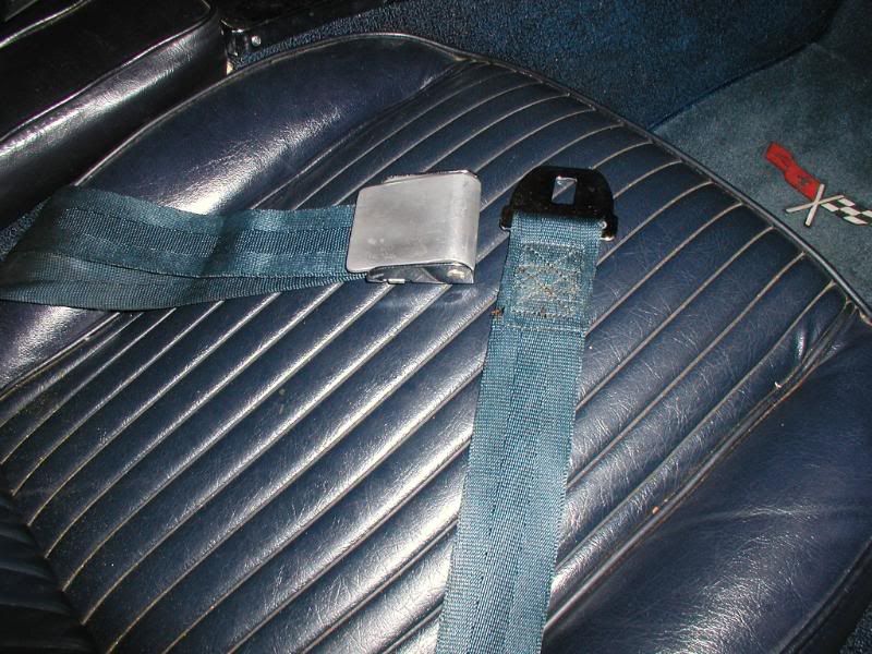

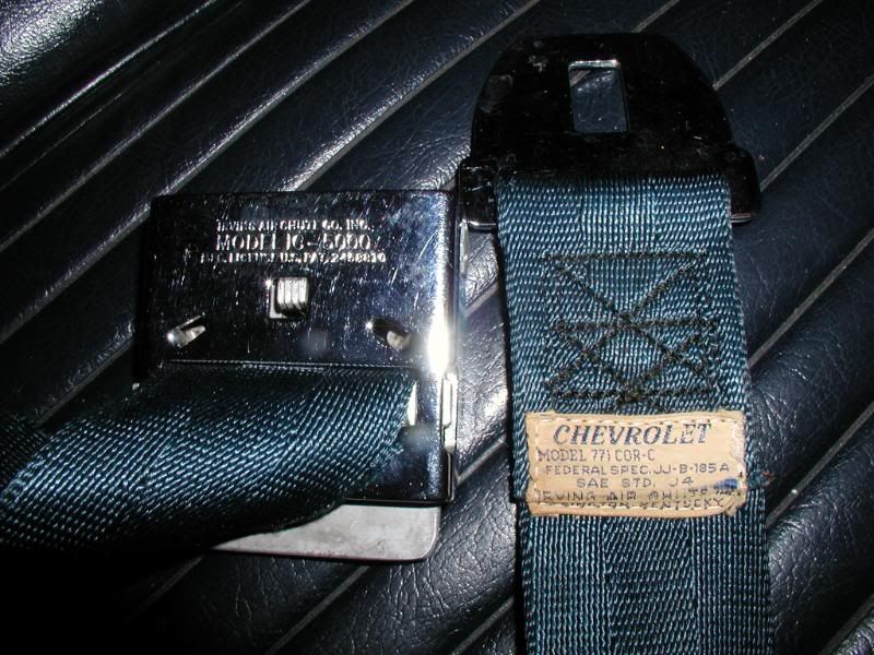

                I believe the belts on my blue 63 car (serial number 39xx) are original. They also look identical to pics posted by Tim Barbieri (below).
                Someone has suggested to me that the tag "might not be correct", but I cannot see any problem when comparing it to the original one's from Tim's car, one that was built shortly after mine.
                Can someone verify that these are good?
                Mike

                  The tag in your picture is correct for 63 Corvettes prior to approximate VIN 7000. The JG has the information switched. My picture depicts both early and late tags as well as examples of the current reproduction tags for both styles.
                  tc

                    Thanks, Tracy, that's good information; one less thing I need to deal with...

                            I am curious as to the size of the middle line on stamp on the buckel back on your's and Tim's belts. Is the font size the same as the upper and lower line or is it the larger size?

                              By the way Tracy, you asked a question that I did not see, so I did not answer, so here goes a belated attempt (sorry): The font on the middle line on the back of my buckles is larger than the font used above and below, similar to that on shown in the pic of Todd's buckles.
