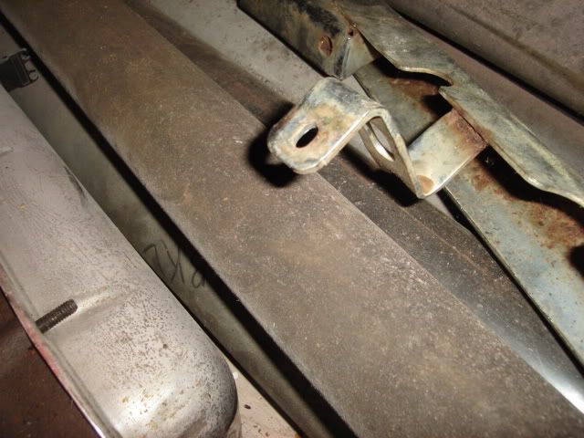

              This is my A22 of 70 built car.
