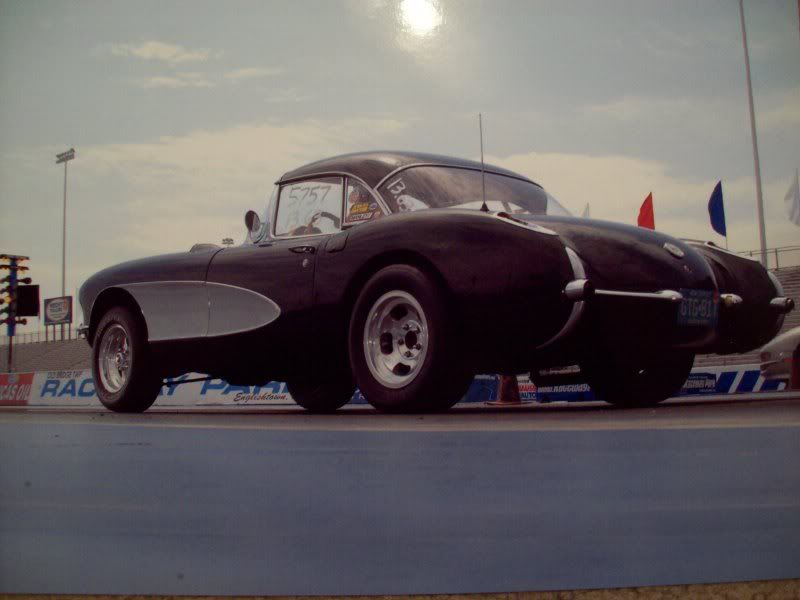

    Also, this is a picture of Lou's 57 drag car.

        What track was the picture taken at? Dale
        • Greg M.
          • April 1, 1998
          • 119
          Re: FINALLY, I got a copy of the service letter for steering box lube!
          Looks like Englishtown!
