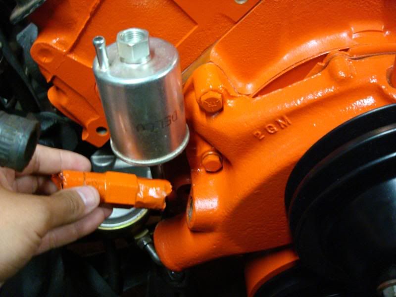

    If this supposed to be a natural finish or painted?
    This is off my 68 l36..

      Re: If this supposed to be a natural finish or painted?
      O well I gave it some sealant cleaned the orange paint off I had painted it with and installed it bare, if anyone thinks thats wrong just let me know
        Brandon
        Sometimes its hard to get a response, but on my 68 L36 it's not painted, but I am no expert. Its drives just fine with or without paint.
          Brandon,
          Check your AIM.
          If it is listed with a part number in the L36 section, then it's not painted as it was installed in St Louis.
          If it is NOT listed, then it was installed at Tonawanda and was likely painted.
          So, you can find it out with a little research.
          Patrick
            Brandon,
            Check your AIM.
            Patrick
            Hey, good thinking Patrick and I do have an AIM so I'll take a look!
