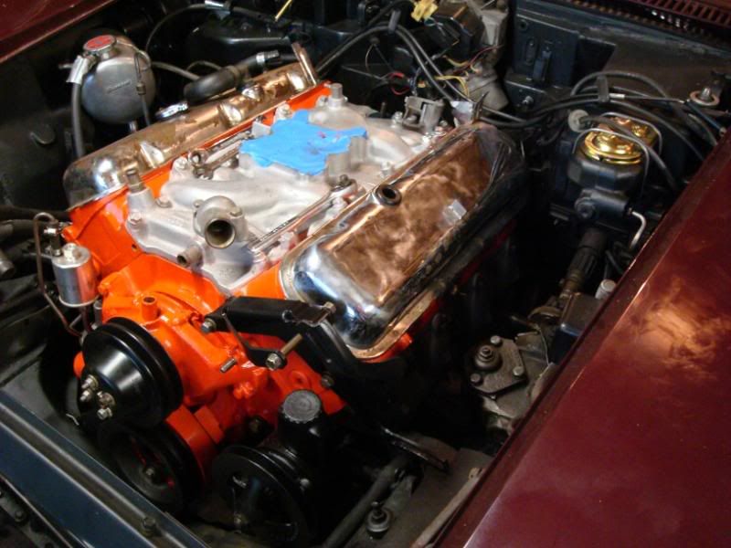

    here ya go

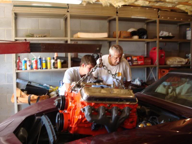

    my dad and my younger brother
    me
    fully in and a few other minors on

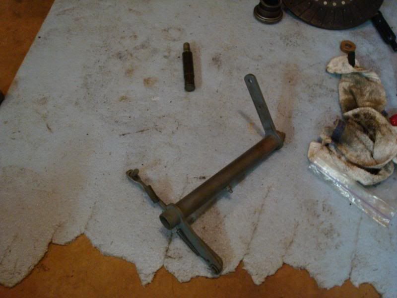

    although it's installed what is the correct finish on the below? I blasted it then gave it a light spray of primer..just didn't think it should be black so left it.

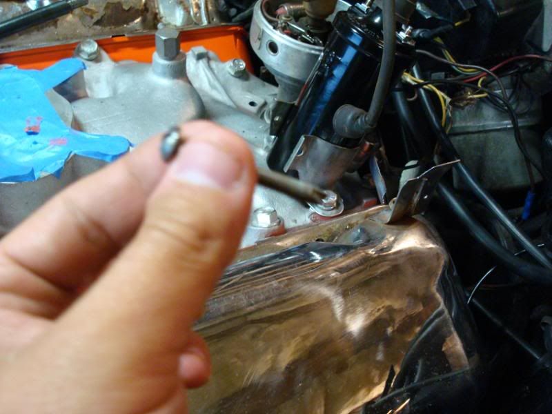

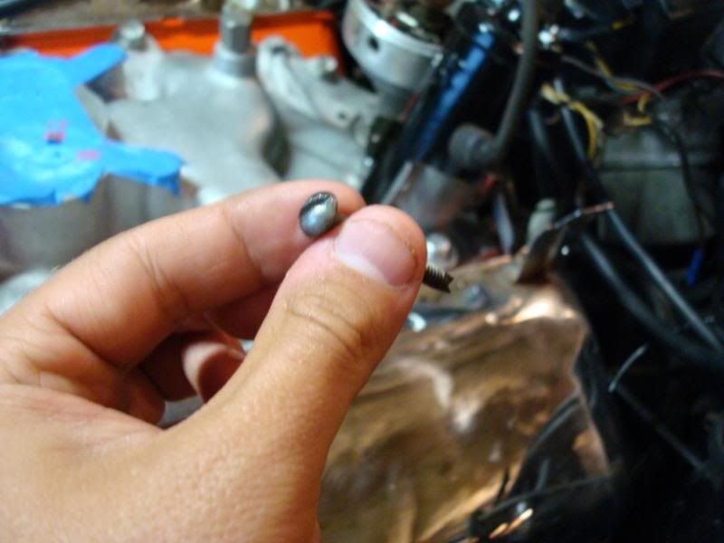

    ok one last thing..is this screw correct for the bracket that goes around the coil? with my new coil installed it seems a bit short, and looks to be a self starting screw, is that correct?

      Clutch bar (also known as Z-bar) should be silver colored plate -- probably zinc.

      That is the right coil bracket screw and there can be a lot of reasons the coil is too fat -- repro coil, or phoney baloney cover over the coil, and I think newer coils may just be fatter (as we age we all get that way -- well almost all of us. ). I am seeing this problem and a lot of creative "solutions" more and more. None of the "solutions" I have seen are good ones.

        thanks!
        as far as the coil I ordered a new delco remy 287 I think is the number..it fits just as tight as the original, so ya the original was just as a tight of fit.
        I guess thats just the way it is, I just thought maybe someone put the wrong screw on it.
