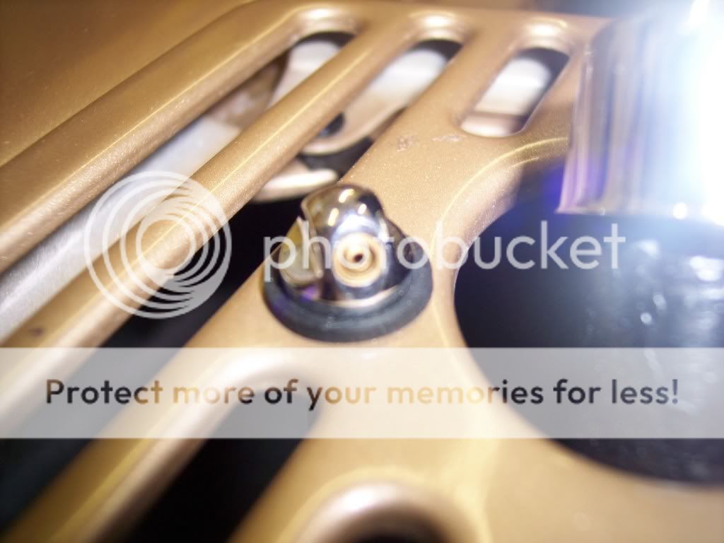

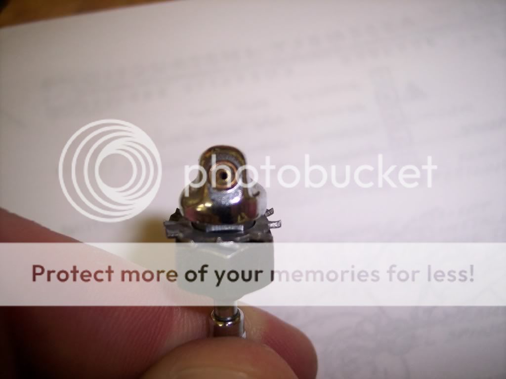

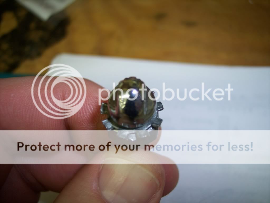

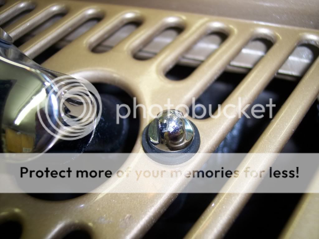

    Flight Judged that my washer nozzles are not correctly configured or cut out is incorrect. The current ones on my car were NOS units I purchased a while back and the second ones are a supposed set of originals I purchased from a well respected vendor. Can someone look at my pictures and give me an opinion on what's right and what's wrong? I don't want to install the second only to find out the first set is actually correct.

              Hello Craig, I'll try to describe what I see from your pictures. The nozzles you are holding in your hand look original "to me". The ones bolted to your wiper grilles look like the current reproductions with the movable brass squirters.
              Here are the differences in the 2 nozzles. The originals have a much smoother transition from round surfaces to flat surfaces like they were molded that shape. The reproductions look like the flat surfaces were machined out of the original castings. Also the original squirter balls were held in by brass retainers that have a radiused shape to them and the reproduction retainers have a flat shape to them.

                  Craig - I agree with Joe in that the "hand-held" ones look to me to originals and for the reasons he indicated. Pete
