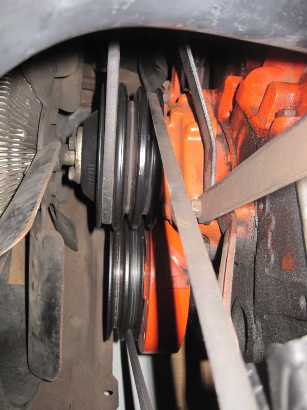

          related to this older topic - I have been verifying my pulley set up of my March 69 L46 w/o PS and AIR. Reason is because I have issues with the length (too long) of the alternator belt and the belt between water pump and fan (removed on below pic) - both fairly new Quanta belts with 3000 miles or so - pulleys are also new. This is my set up and looking at the AIM this seems to be correct -
          Question - do I need a belt between the water pump and the fan?
          The current belts are 9 mm wide (is that 3/8 inch?? - sorry I am in metric country) - is that correct or shall I try current day generic replacements which are normally wider?
          Thanks again, erik

            erik-------
            Yes, you need a belt between the waterpump and the HARMONIC BALANCER PULLEY (no such thing as a belt between the waterpump and fan).
            You will need a reproduction belt for the waterpump-to-balancer application; the length has to be exact and no standard belt will be exact.
            Most original belts were 3/8" wide.
