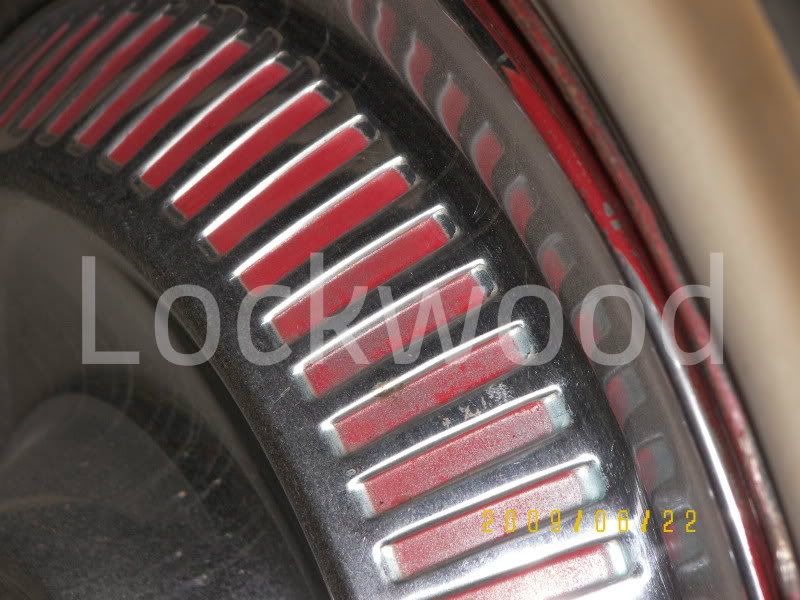

    I just got my hub Caps back from the chrome shop (dents, chrome and polish repair) I need to re paint the red in the little slots......What I see is the slot is not full of red paint when they masked it off to paint they left a lot of area unpainted..... My question is Do I follow the same lines or fill the slots so it looks better or does it matter?

    I dont think it matters in judging but some one that knows there not completely paint would ,

      Thanks Roy; I'll start masking them off next week.

            Roy noted that all '53 - '55 wheel covers were painted similarly. The photo below is of one of the unrestored wheel covers on my '54.
            The red clearly does not fill the slots.
            Also note that the mask used by the factory did not completely cover the wheel cover and there is red paint right at the edge where it turns under. All four wheel covers on my car show this to varying degrees.
            As to color, the wheel cover red is, to my eye, indistinguishable from the original red of the wheels themselves. This isn't apparent in the photo due to the angle of the camera; straight on, though, it's very obvious.

              Thanks Jim; The Picture shows it all. Bob
