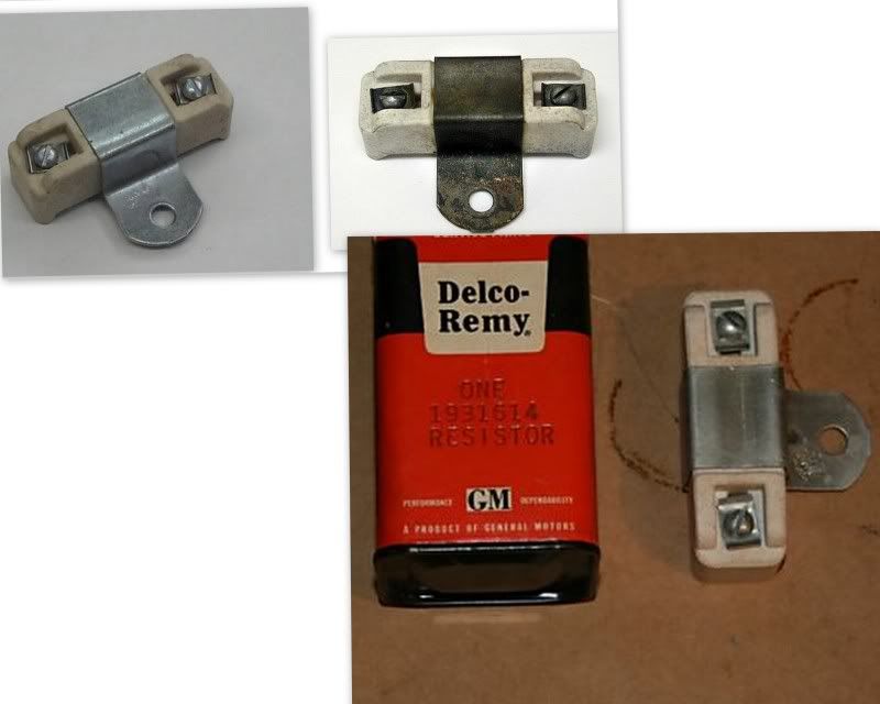

      IF your looking for the real deal original first "design" this is what it should look like.

        Re: C1 and C2 Ballast Resistors
        roy's picture is correct for at least the 56 and 57's. note the lack of a notch in the porcelain on the sides beneath the screws. mike
          Thanks mike I knew 55 to 57 but wasnt sure about later C1's
            Which one is correct for a 62, 250hp-327? Notch or no notch?
              62 I'm not sure of but some here should know, I know 55 to 57 mostly
                My recollection, based on 'harvesting' ballast resistors, is the ceramic change (trough from the center to the screw terminals vs. trough all the way through to the outer ends) came along in roughly the '58 model year...
