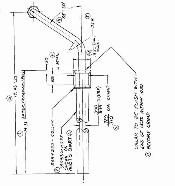

          In regard to the return line clamp: According to the AIM and the TIM&JG the clamp should be a crimp type not a screw type, it goes under part # 5690839...see picture.

            I just ran all of the pump to valve hoses through the GMPartsDirect websight. None of the pressure hose part numbers come up any longer (SB flare end 3826277, SB metric o-ring 7834409, & BB flare end 3878886). But the return hose assembly 3826278 still shows up as a good part number.
            As far as I know, the return line hose always had a crimped collar that held it in place on the tube assembly coming out of the valve.
            I wonder if the service part still has that collar or if a typical one eared crimp clamp (Oetiker) is used for service.
