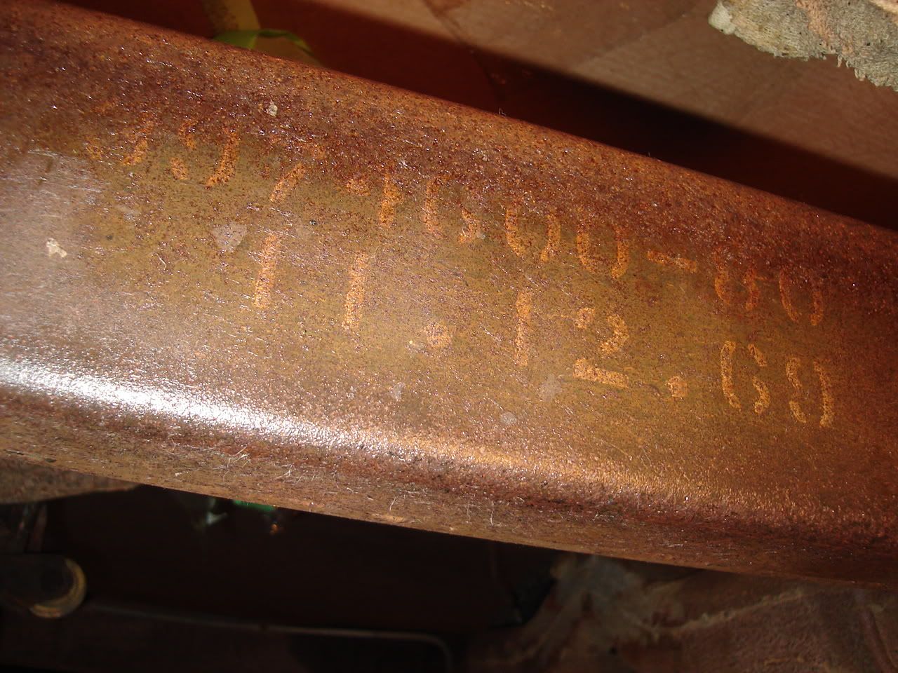

    I am confused about the location of the frame stencil on a 70. The C3 registry has pics of two cars. One has a stencil infront of the rear wheel. And one has a stencil behind the front wheel. Was there a stencil in both locations? Where should it be on a Jan built 70?
    • 11666
    Re: 70 frame stencil
    Keith,
    Side of frame just like in the picture:
      What about the one behind the front wheel?
        • 15616
        NOT 1970. Behind the front wheel is 1972.
          • 11666
          Yup.
          That's why I said side of the frame.
          • Keith L.
            • April 7, 2008
            • 378
            16838 G28 Build date. Frame Stencil: passenger side, behind front wheel well, from a LS-5 454/390 Hp engine. Vehicle #00531, built 09 Jan, 1970.
            This is what had me confused. It was right under the other pic showing it in front of rear tire. I just wanted to be sure where to try some Evaporust to see if I can read mine.
              • 15616
              I think that #531 frame stencil is an anomaly, but then there are some real unusual early 1970 features -- such as no VIN stamp on the stamp pad.
              Do not fall into the trap of restoring your car like every other Corvette you see, unless every other Corvette you are looking at was on the assembly line right behind or right in front of yours. That one was no where near the plant when your 1970 was built.
              Yours might be behind the wheel, but I would bet against it. Note the date on the stencil Patrick posted. Compare that date to the build date of your car. BINGO.

                  Here is a late 71 frame stencil
                  I usually don't get to add too much, but here are some shots of my late 71, #20992 and it's stencil location. It appears to have been in the transition between years as it has an intermix of some 72 parts and lacks a water shutoff valve and vacuum line for the heater core. Also, it was crayon marked on the driver's side of the frame with "1972". Maybe someone will find it useful or interesting.
                    I found it. It was not visable at all but I dipped a towel in some Evaporust and started blotting the area it was supposed to be and in a minute or so there it was. Dated earlier than I expected for a A22 build. But can't argue with what it says.
                      Glad you found it Keith. I found that using something wet like you did, made all of the chassis marks visible. Sometimes it required a light rubbing. I found only one other mark outside of the usual ones, shims and frame data.
