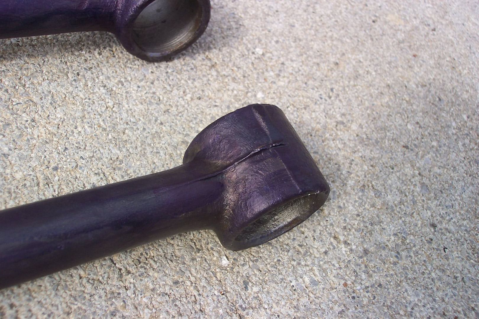

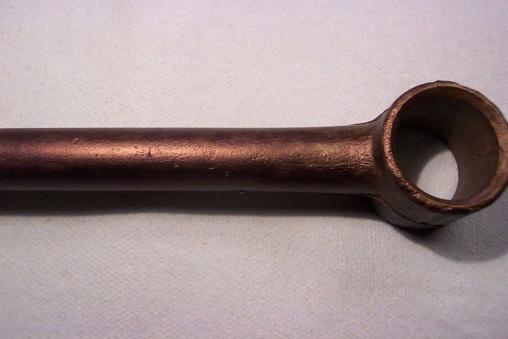

    The last pictures I posted were after I had utilized gun bluing. The strut rods were a bit more bronze than blue. Now I've dabbed blue layout fluid over the glue bluing. I'd like some opinions of how the look. Keep in mind, I had increase the amount of blue by applying more layout fluid.

    1970 Strut Rod Restoration Revisited
    Steve,
    Can you show an image that shows the entire strut rod? Up close, the surface finish looks pretty original looking to me, but it would nice to see the entire shaft in good lighting. Exactly what bluing did you use and where can one purchase it?

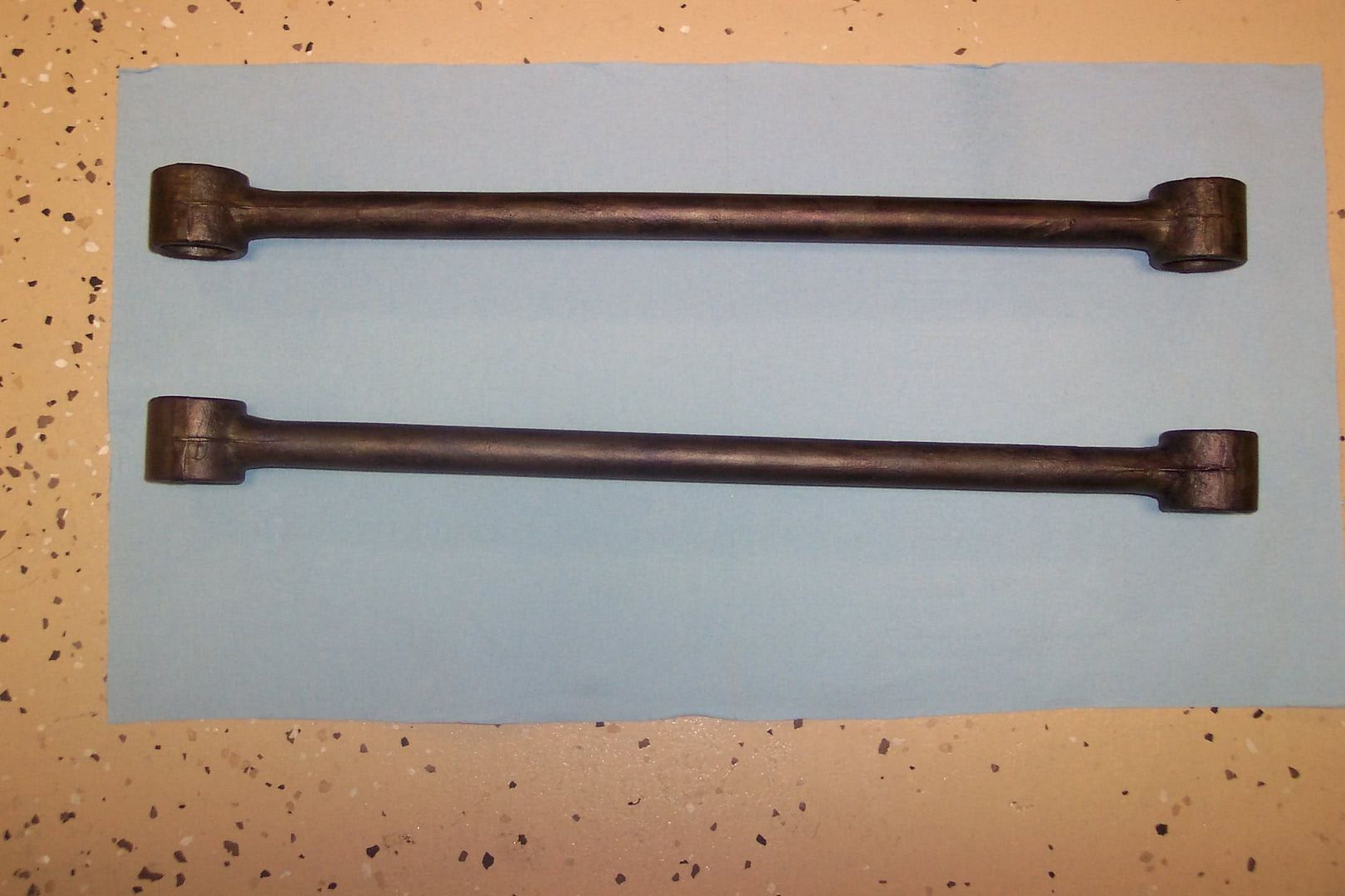

      Here's a picture of the complete strut rods. Notice the blotchy bluing. I started with gun bluing. They turned out more bronze than blue. Next I dabbed blue layout fluid over the gun bluing. I tend to think that the strut rods need a little more layout fluid dabbing.
        Stephen,
        Your technique looks very good to me. I judge mid-year chassis and based on the photos, I don't see grounds for any deducts during judging.

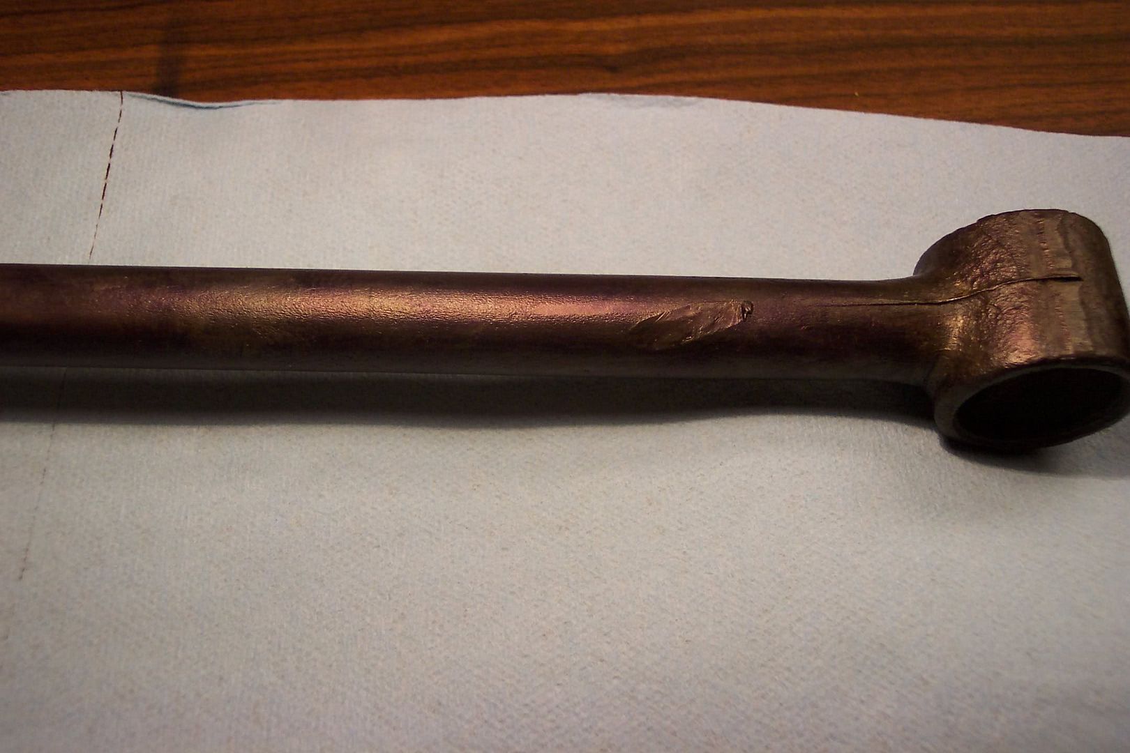

                  This time I put a heavy coat of layout fluid on the strut rods. They definitely are blue.

                    Re: 1970 Strut Rod Restoration Revisited
                    Steve, there was a thread within the last month or two in which someone posted a picture of a Pitman arm that has the most gorgeous as forged finish I have seen since I worked in a metallurgy laboratory. I wish I would have saved that image. I hope someone can find it for us.
                    • Stephen B.
                      • April 1, 1988
                      • 887
                      Terry,
                      I'll look for the picture. Do you think the finish is too blue? I can tone the blue down with rubbing them with laquer thinner.
