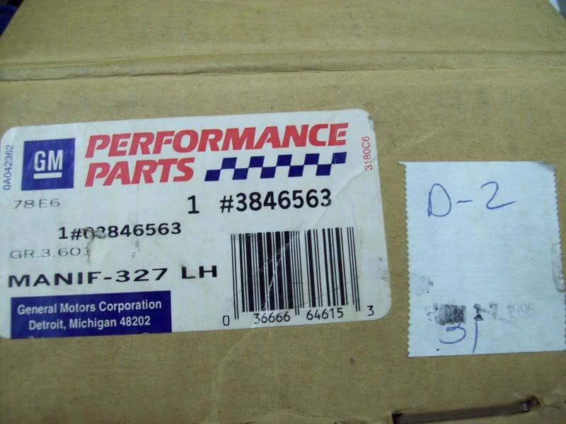

      This is a 563 dated Apr 17, 95 and the box it came in with a Jun 17, 95 date.

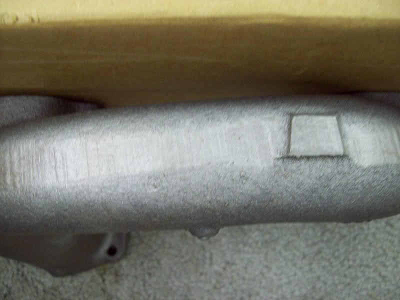

      This is the top of that same manifold where a grinder had been used to remove the parting line. I smoothed down the grinding marks somewhat then blasted it to reduce the "ugliness".

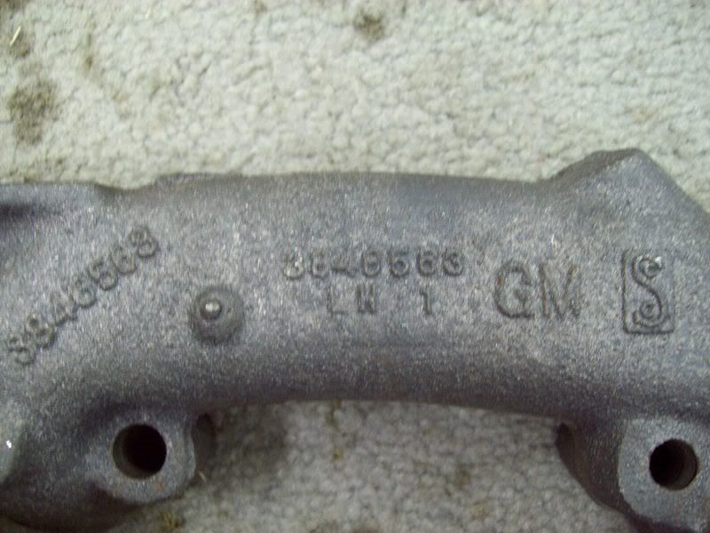

      This is another 563 with NO date, but a logo that I've never seen on any other manifold.

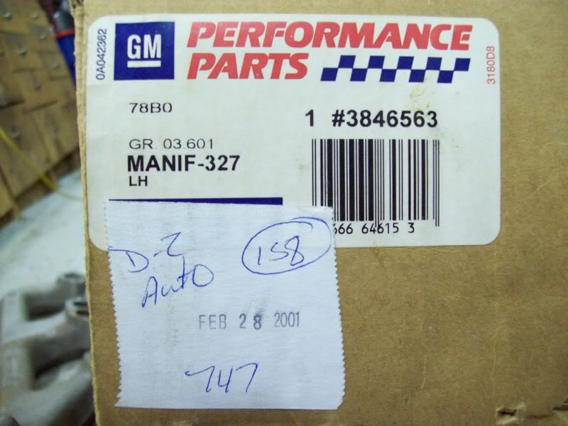

      And the box it came in with a Feb 28, 01 date.
      This is the top of that same manifold. The grinding marks are not so bad, so I didn't try to smooth it out any.
