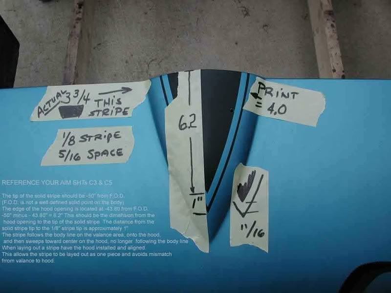

    Can't seem to find the width of the pinstripe painted on the BB hoods for 1967. Also, what was the spacing between the pinstripe and the center paint?

        complements of another forum ......

          Some time back Wayne Womble posted a picture with measurement of an original hood. Do a search under his name

            That is our own Steve Lavigne's photo, but it is so good it really makes the rounds (I know I have posted it a few places). I guess a picture is worth 1000 words.
            Here is a photo Wayne Womble posted, I am pretty sure it is the same one Dick is talking about.
