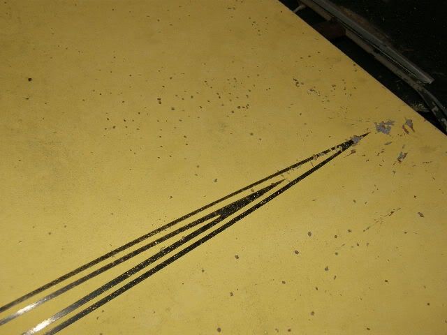

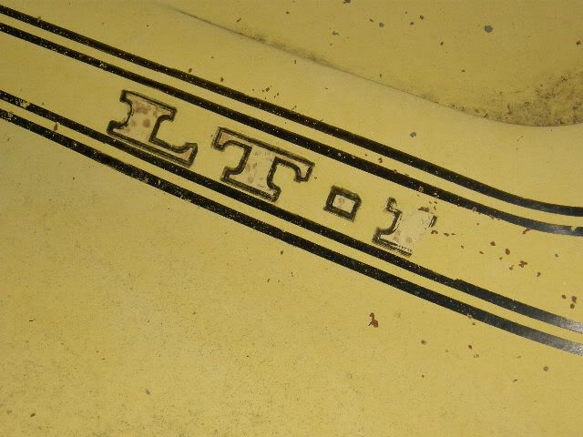

                            Re: Painting the LT-1 Hood Stripe
                            Here's my Jan 70
