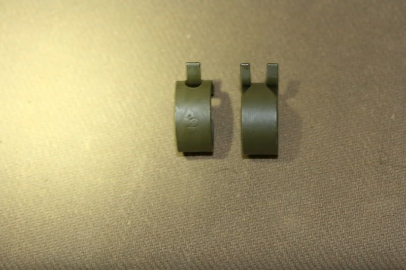

      Re: Green Finish/Color on Fuel Pump Hose Clamps
      Not such a great shot but more indicative of the true color.

        #18
        MARK-
        Nice shot, way better than the one I posted (need to get a better camera than the $29.95 one I have). I also can see the original stamping from the manufacture in your picture. That's what I like about restoring original pieces if possible. I like all those little details even if they're not judged. I doubt that the repro's have any markings on them, anyone know for sure?

          #19
          Originally posted by Tom Russo (22903)
          Ok Donnally...now that you've piqued our curiosity...are those original are have mastered the art of restoration?
          Hi Tom
          Those goofy judges can spot a filed hose clamps. I not that goofy but was an OJ judge and I did have my specks on and did pointed out the filed end on a car getting top flighted. Only lost a point but he still did get top flighted. Originals have a die cut ends, it has that sort of flared end at the very edge. Very hard to repop that. So I guess that is why the judges carry magnifying tools too.
