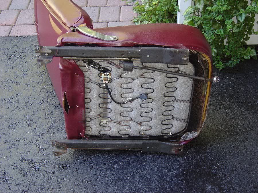

    Can anyone out there tell me the secret of seperating the Lower (floor) side track from the Upper (seat) side track? I know there's a stop in there, I just don't want to "Bubba" it up trying to get the 2 apart.

    Hi Martin,
    There was a thread about seat tracks back in June of 2007.
    I believe there are some heavy rivets at the ends of the tracks that need to be drilled out to separate the two parts.
    I ended up restoring mine with the parts together. I was able to phosphate the 'feet' well enough with out removing the tracks.
    My tracks have what I assume is a nice distinct Julian date on them which I've never heard mentioned. My car a 71 was assembled in mid- January, 71.

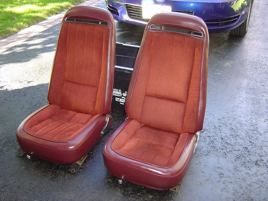

                Re: C-3 Seat Tracks
                Marty,
                I managed to get the job done. The Meguier's #40 dulls with time but still protects. I can't match the beauty of your 1974 but I am happy with the outcome.

                  Re: C-3 Seat Tracks
                  PAUL-
                  Looking fantastic, job well done, hope it didn't set ya back too much. I like your "feet" buckets, where did you get them?
